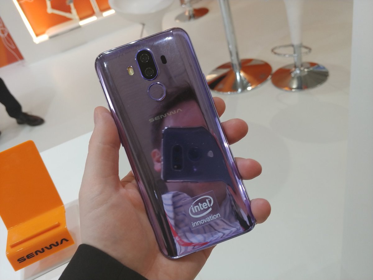

I assume this was at MWC, but it appears there is another Intel/Spreadtrum powered Phone there from a company named "Senwa", with an Octocore Airmont based CPU.
Intel Phones - Ian Cutress
Octacore Airmont - Ian Cutress
Let me bet... Leagoo all over again?
Intel should give them better modems and more bands... oh and Asus should join it too.
BTW... Airmont octa cores are nothing if they have a crappy GPU... Who in the hell are putting a Mali T820 on it? *looks at Leagoo T5C*
Here is a video how the Airmont cores performs.... along the crappy Mali T820...
https://www.youtube.com/watch?v=mXL_lH4hrsA
Intel should had continued with Broxton. Along continued to use Power VR GPU
BTW... Airmont octa cores are nothing if they have a crappy GPU... Who in the hell are putting a Mali 820 on it? *looks at Leagoo T5C*
These are meant to be insanely cheap so don't expect high end anything from them
Intel plans to give them better modems, they just announced another partnership with SpreadTrum to supply 5G modems for their SoCs, they showed a Early 5G Modem at MWC in a 2in1 that supported 2G-5G and upto 5Gbps, now they got to shrink it!

Even being cheap doesn't mean that was supposed to be a bad quality GPU...
And is a mid tier phone. If it was using SoFia it would be understandable
