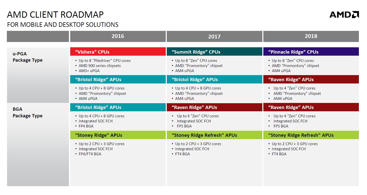

After Stoney Ridge Refresh, it looks like the AMD ultra-cheap roadmap goes dark:
