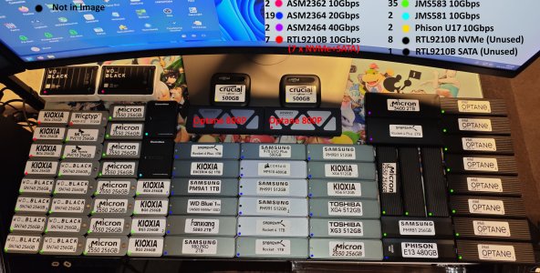

I have BG5's and BG6's but cant be bothered testing
as i dont want to go buy more RTL9210's to replace the JMS583's if there turns out to be problems
i doubt it though the controller is built into the nand on the BG4's BG5 is external BG6 is a SMI2268XT
I have too many JMS583's to go testing too indepth..

XG3,XG4,XG6 are fine in all enclosures its the dramless models that get problems in certain Enclosures
For example WD SN740 gets IO resets on pc reboot on one chipset cant remember if it was ASM2364 or RTL9210B
i think it was aleviated with a firmware update on the SN740's at some point cant remember
Samsung PM9B1 gets an io error on reboot also on one of them cant remember which
BG4 you know about with JMS583
