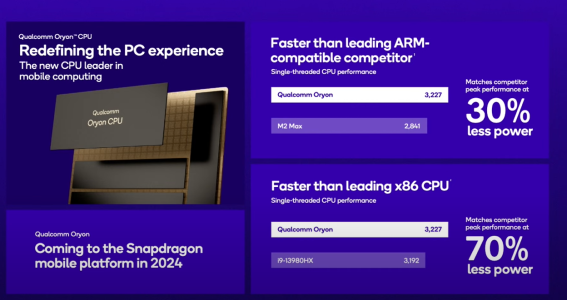

Not necessarily.
The 13800H performance that the Snapdragon matches in CB24 at about 32W total power (65% less) is about a 976 apparently. Qualcomm’s peak performance is about a 1229 on CB24 for the “80W TDP” which here would at least be similar to the actual peak. And then it’s 1022 in the “23W TDP” config (which tells us nothing about the power though we do know the MT boost clocks there should be 3.4GHz).
Anyway, with some margin of error here it’s about 1/4-1/3 more from the 32W point where they match the 13800H to the peak for QC on performance which would make sense and puts you around the 1229 range more or less (or the 32W point is lower rather).
So say the MT is 950 @ 32W. Yeah that’s worse than the M2 Max, but not by much, and take it down to 20W where the M3 is, it’s steep but should still be within 10-15%. That’s all assuming the calculations here are even roughly accurate and the graph is representative.
I’m not that worried tbh.
I'm not worried either.
SpudLobby
May 18, 2022
1,041
702
Yeah, though FWIW, I think the M2 Max at peak will draw like ~ 20W when measured from the wall on ST from Notebookcheck in Single R23 (and shouldn’t include display since it was in an external monitor). This is only one measurement though. But fwiw the M2 or M3 are like 8-12W by the same reports.
It’s also -30% less power @ the M2 Max’s ST performance, not 30% *and* more performant simultaneously. Still, the M2 Max is usually about 7+% faster than the M2 Pro or M2 thanks to a .2GHz clock boost and probably more headroom on bandwidth and background tasks.
If Qualcomm is matching the M2 Max at 30% less power, and we say the platform power consumption for ST stressers is 20W, then you’re looking at a ~ 14W draw for the whole stack for what is like a GB6 2840 *if* we take notebookcheck’s numbers seriously, and if CB23 has rough power similarity to GB6.
In practice I expect it’s a bit better than that power consumption, but something like 10W for the whole platform when one core is gunned to 3.8GHz would make sense. Keep in mind also Windows performance isn’t as good as Linux for now afaict probably due to scheduling. So the “23W” version with a 4.0GHz boost scores more in the 2700-2800 GB6 range on Windows, and since probably at about 3.9GHz is where it’s M2 Max-tier on performance, probably take a hare off that GB6. Then you have the matched performance on Windows that takes -30% off the M2 Max power draw.

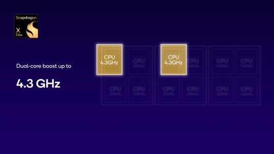

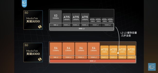

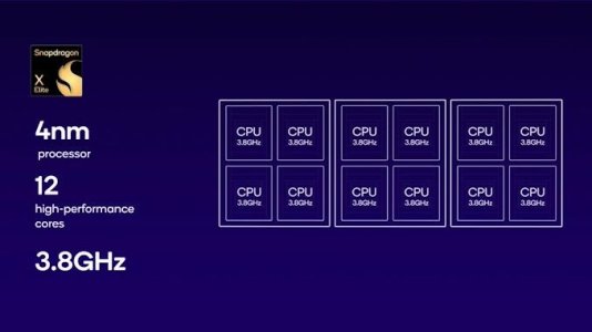

I'd agree here on the die sizes. Qualcomm allocated differently: 12x P-core, vs Apple's 4+4, and they squeezed a lot into a relatively tiny die.
Maybe Qualcomm is doing what MediaTek 9300, Intel MTL, and AMD's Zen4c do: only two P-cores get the full die size for peak frequency.
SXE (80W device type): just 2x P-cores can clock to 4.3 GHz, the other 10x can only hit 3.8 GHz?
I thought first, 600 MHz isn't much compared to AMD's Zen4c. Can Qualcomm really save much die space? But then MediaTek's design gave me pause: even if Arm's relatively small X4 cores can achieve a noticeable shrink with just a 400 MHz reduction, Oryon may well be the same.
The Dimensity 9300 still uses a three-tier CPU approach here of sorts. One larger Cortex-X4 core is clocked up to 3.25GHz, while the other three run at 2.85GHz. MediaTek notes there’s no difference to these cores in terms of cache, only that the higher clocked core is laid out with a larger silicon area to enable the higher frequency.
My only quibble on comparing SXE with M3 / M3 Pro: per-die cost could depend on volume ordered. Apple reliably sell tens of millions of Macs, so Apple may get larger TSMC volume discounts than Qualcomm, who may be more cautious for this first-gen Windows on Arm SoC.
So an M3 Pro, even with a presumably larger area, may still be cheaper than Qualcomm's SXE, so they could occupy the same price segment.
My guess is that it is a quality yield (parametric) issue. All the cores in two clusters in particular (they said this indicating the third is different) are probably physically designed to hit 4.3GHz — maybe a bit more — but with yields you get variances, so only 1/4 in each is capable of 4.25GHz(4.3). Though it’s also possible one core in each batch is physically a bit bigger using more performant cells or whatever. They’ve done this with A7x cores on phones before so.
> “Meanwhile in lighter workloads, the chip supports turboing up to 4.3GHz on 2 cores. Qualcomm’s slide on this matter shows a core from each cluster, but it’s unclear whether this is some kind of prime/favored core in action (where only certain cores are designed/validated for those speeds) or if it’s simply a stylistic choice.“
So it could be either way — it could be two cores that are capable on a yield basis per each die — chosen cores out of firmware or whatever and different ones for each part — or they could each physically be distinct. But fwiw, they are probably not that much bigger if they are even different.
Unless Qualcomm is keeping a ton of clockspeed in the tank, 4.3GHz vs 3.8GHz isn’t that huge. These are still going to be relatively dense cores.
I also want to point out that L2 is a part of this, and these cores share L2. So if even one of the cores is clocked higher, any density savings in the cache would be destroyed by that because they need to be able to support the fastest core.
Most important: AMD targeting up to 5.7GHz on the same process, 5.2GHz on the mobile versions. When something does less it’s just yields. Zen 4C is capable of about low to mid 4GHz apparently fwiw. It’s a much bigger range of variation for AMD and they’re also pushing a much higher clockrange relative to the process. Qualcomm, even if they do have prime core designs which they don’t seem to disclose (leading me to believe this is just a yield thing and each die’s 4.3GHz cores will differ) are not going to save like 30-40% on area here.
They are absolutely smaller, but you have to separate the architectural and L2 difference from the physical design necessary to support x y z clocks.
Those smaller X4’s have 512kb of L2, not 1MB like the one huge X4 — Arm allows this as long as you have one huge X4. Second of all, those smaller X4’s that tag along have 2x128b vector/SIMD units instead of 4x128B with the regular X4. Another new Arm thing.
EDIT: I see MediaTek mentioned they’re laid out with larger silicon too.
Yeah fwiw I think you hit threshold effects for a given process node where you have to use larger silicon even if it’s still dense cells or whatever. Like as a probabilistic thing if you want most chips’ X cores to be able to hit some frequency, probably at some point you have to just change the phydes of the core(s) so a higher or very high proportion of them are able to do so.
It could also be about timing for this particular design too, idk.

Also in the Apple M3, only one core can hit 4.05 GHz, and the others top out at 3.6 GHz iirc?
No, for 4.05GHz, it’s only one at a time, but that’s standard. Apple has never done the prime/non-prime thing where one core has a bigger physical design than the others for frequency. All of them can hit the peak, it’s just that their all core frequency is lower than the peak.
I could be wrong and for the first time they did differently now but I doubt it.
Then Qualcomm might be doing the same thing, no?
Snapdragon-X-Elite-Pre-Briefing-Deck-5_575px.jpegSnapdragon X Elite Pre-Briefing Deck 7.jpeg
View attachment 90914View attachment 90915
Yeah they absolutely might, except they also seem to highlight that it’s one core in each cluster in a way that makes me think it’s actually one core that makes it. Again one core doesn’t necessarily mean they’re physically different, they can assess which core can actually hit that frequency in assembly/packaging or the firmware can know, similar to how Intel has in the past had preferred cores. But yeah it might also just be that only one core at a time is capable.
Just take a peak at the die shot
Yep that doesn’t show any unique P core.
