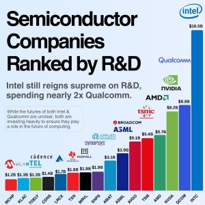

Found some numbers from 2017 to compare to. Interesting definition of "semiconductor company" in the above numbers. Companies that make chips using IP they own like Intel are included. Companies that don't make their own chips but own the IP like AMD are included. Companies that only make chips for others but don't own the IP like TSMC are included. And companies that make the equipment that makes the chips like ASML are included. That's about as wide of a net as you could cast without catching Apple, I suppose.
Very good catch that the omission of Apple seems to be an oddly specific one.
The source is the key to understanding this. When investing, one of the traditional key concepts is *industry* (not quite the same as *sector*, which is more encompassing). Companies in the same industry operate in the same sphere of business and often behave similarly and share underlying risks and cyclical trends.
The fact that Apple designs chips is wholly secondary in terms of its trends and underlying risks. It might well be critical to those of us here in a very technical forum and it does expose that these industries are somewhat arbitrary and some companies can be lopped into different ones by different investment firms or even into multiple ones. The larger a company gets and the more industries, the more nebulous the concept becomes.
Apple, for reference, is usually lopped into the big bucket industry of Information Technology.

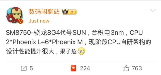

Snapdragon 8gen4 leak:
DCS: 8G4 is codenamed SUN, adopts 2+6 structure, and the production process is TSMC 3nm.
Furthermore, he made an interesting statement, saying, "The design performance of Qualcomm's Oryon architecture has significantly improved, posing a threat to Apple."
We constantly keep hearing about Phoenix-L and Phoenix-M. Does no one want to about these?
