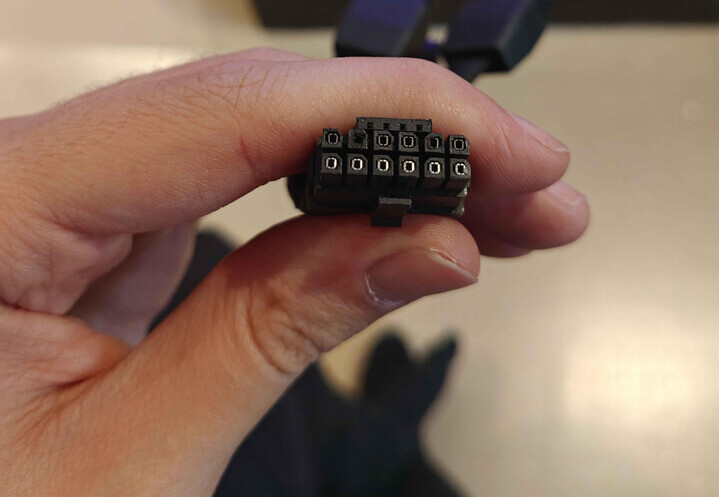

The first RDNA4 card has fallen. Press F:
I just got the Taichi as well. I'm not using the el-cheapo included adapter, though.
I checked my input voltage reading under max load at max power in HWINFO compared to my 3x8 pin mercury, its only 0.014v lower. (0.115Vdroop on mercury, 0.129Vdroop on Taichi)
It would be interesting to get people to measure their PSU 12v rail and then read the GPU input voltage (mine reads in hwinfo) and calculate vdroop to see if we can see variance or excessive cases, which would seem to imply poor connection and might predict a melting case.
Apparently the card was fine, it was just the cable. But, it seems consistent with problems seen on some 4090s (e.g. one pin was hit harder than the others). Has anyone done a breakdown on the power delivery for this model of 9070XT?
Same as every other 12v2x6 card, all the pins are bussed into one single 12v rail
And here, endeth the lesson....
This cable and connection can not be trusted as safe without proper overcurrent power protection. Ideally, we would see the protection happen at the power supply side, placing fuses or overcurrent protection circuit on each of the outgoing 12V lines to prevent more than 9 amps that the lines are certified to handle. Alternatively, the cards need to keep each of the pins separate and provide a similar protection circuit on each of the incoming lines.
