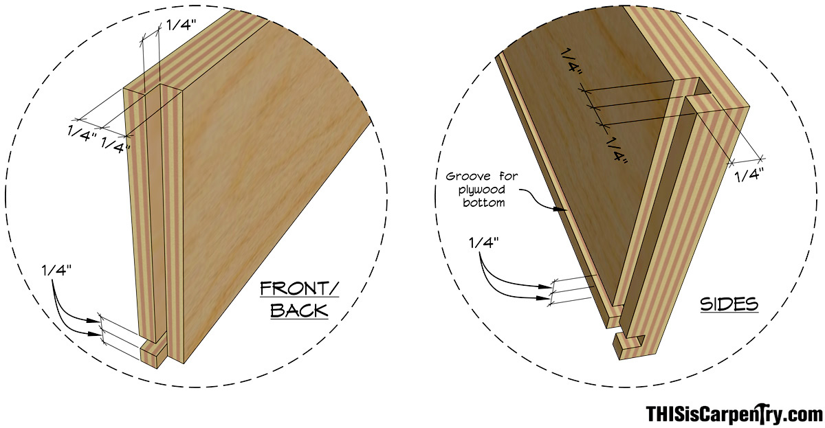

This is how I knock out quick drawer boxes on the table saw.
Once you get the stock sliced and diced, set up the dado and get cracking. It goes fast.
I glue and clamp but a few finish nails as a belt and suspenders is OK too.
I make them out of various thicknesses of BB, the big pots and pans drawers I think I used 12MM on.
