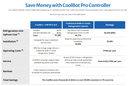

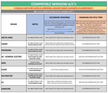

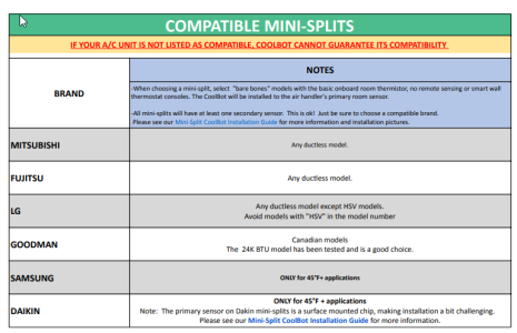

Yeah, DIY is what I initially looked into. It's called the CoolBot, which is a custom window A/C controller to build your own walk-in fridge in a shed or room or whatever:
$419 & includes an app. Unfortunately, it only does refrigeration. However, it's pretty budget-friendly & uses 40% less electricity than a traditional walk-in fridge. You can use a window A/C unit or a mini-split system (compatible units listed below). You can build your own walk-in or a mobile trailer. They also sell walk-in kits:
TONS of uses (restaurants, home fridges, meat processing, mortuary, flowers, etc.). The benefits of the RootCellar version ($$$) is that they handle the whole process, customize all of the options for your preferences, can add a freezer unit (not available with the Coolbot), add a hands-free automatic pocket door for convenient entry & exit, etc. Right now, I have a 20cf upright freezer, which was like $900 delivered & installed from Home Depot, which I'm pretty happy with haha. But one can dream!!
