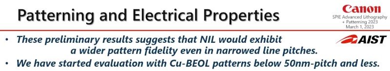

Image edit example:
Canon NIL----------------------ASML 193i

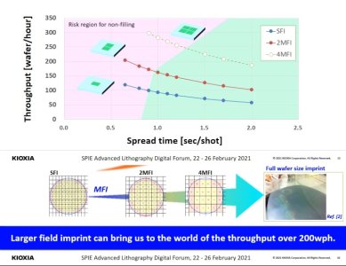

Low-loss and really fast print rate. The flash component can get up to 10000C.
Fill/fluid spread/resist spread time (jet component):
1.5s = 60wph ~ 2015
1.1s = 80wph ~ 2017
1.0s = 100wph ~ 2019
Less dense = faster fill rate. So, it is very important to note that this is probably with >40-nm metal pitch. Rather than <30-nm metal pitch. There is also a bunch of other total optimizations reducing time. So, I can't really use the fill time anymore. Since, they cut time everywhere.
Wait, I'll just do effective time.
0.75~0.8s = 160 wph ~ 2021
0.7s = 190 wph ~ 2023
0.65~0.7s = 210 wph ~ 2025
Yeah, it is probably with larger DRAM/Logic Cu-BEOL:
The showcase only shows 64nm and 48nm metal pitches for logic nodes. [I saw this before, which is why I hinted towards 12FDX]
Also finally found it again:
(That full wafer imprint: https://fuse.wikichip.org/news/3010...r-scale-engine-half-square-foot-silicon-chip/ )

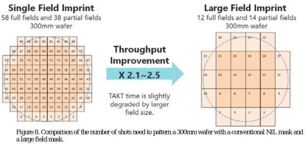

Canon appears to want 4MFI(4x of SFI) to be the standard (May 2019):
This explains the wph increases more better. Increased imprint size => higher throughput. Opposite of EUV, where the mask shrinks NA -> High NA, NIL increases its mask size.
So, 2025 is 4MFI at 1.75s actual or 2MFI at 0.6s. Risk region seems to be improved by Canon over time. So, 190wph might be 2MFI at 0.75s.

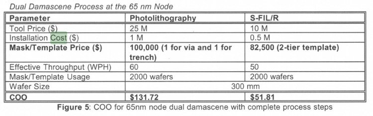

Current day:
193i = ~$90m to ~$120m
EUV = ~$150m to ~$270m
Guessing based on how weird Canon/MII marketed afterwards would basically have to be $40m to $60m. The cost of ownership parity against photolithography has been maintained. Canon's NIL being the cheapest for the 7nm BEOL all the way to the 3nm BEOL. Unlike EUV, only IBM is using EUV for Nanosheet fabrication, can possibly be more aggressively used for FEOL. However, the SFIL to JFIL rename and MII buy out basically killed FEOL side:
