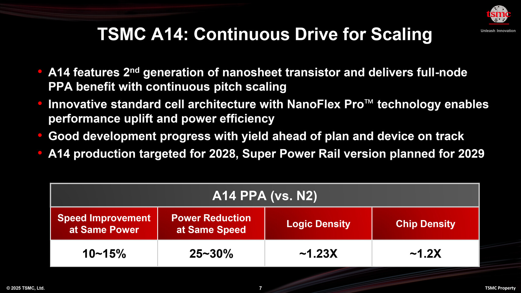

It's half node from A16
Despite the way it is named, A16 is not a half node. A16 is N2P plus BSPDN. A14 will be a "full node" jump from N2, though today's "full node" is less than what a half node was 10 or 15 years ago, so the distinction has less and less value.
It isn't clear yet what TSMC's plans are for BSPDN in the A14 era. Will it remain optional, if so will there be a different name like A12 for A14+BSPDN or will it be named A14S (A14 Super Power Rail) or something like that to denote? Guess we'll see.
The slide says they are doing a version of A14 with BSPD in 2029.
I meant the PPA is worth only TSMC Half node.
