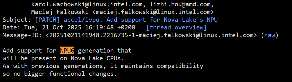

Saw this posted on a other forum today, dunno if it already have been posted.
This reminds me of a rumor suggested 'Intel just didn't have time to implement SMT into LionCove and not a sort of any wise technical choice you guys reading too much into it', while Intel tried to explain how good without SMT is.
Maybe Intel is not going to explain how good without AVX512 or AVX10 is, because AVX512 is still currently poorly supported unlike SMT.
Computerbase reports:
Dokumente bestätigen: Kein AVX10 für Intel Nova Lake, dafür eine neue NPU
Specs verified: NO AVX10 for Intel Nova Lake, but you will get a new NPU

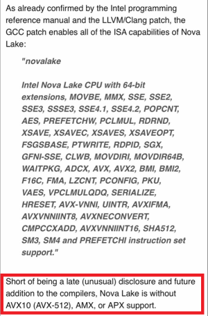

Zen 6 and Nova Lake are looking to have so many cores/threads I'm going to be basing my next purchase decision on which one is better for ST. They'll both crush any MT I do.
If NVL has APX/AVX 10.2 I would choose it over Zen 6 even if it's like 5% behind in ST.

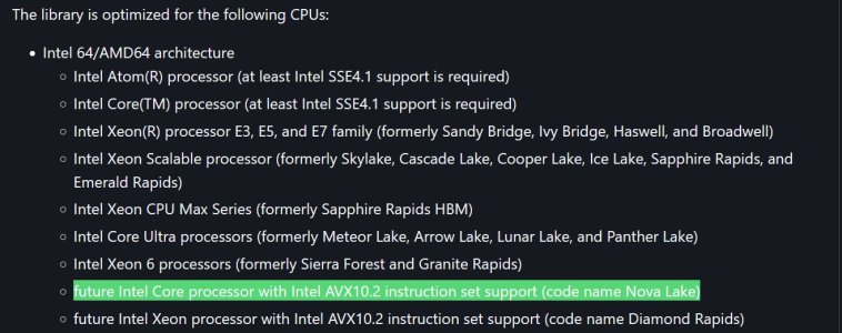

It has AVX 10.2/APX
I don't see anything about APX. As far as I know, AVX10 does not imply APX. AVX10 makes sense as they don't need to go full 512 bit so I was surprised when it looked like it might not have had it. Both will need software to be re-compiled to make use of them, right?
Nothingness
Jul 3, 2013
3,365
2,459
My understanding is that now AVX10 specification requires support for 512-bit. Of course that doesn't mean they have to go with full 512-bit datapaths, but at least 512-bit registers and associated support.
Reactions: Tlh97 and MS_AT
Latest AVX 10 Spec only supports 512bit vectors

How about this: Novalake was supposed to have AVX10.2/APX but since Intel started new initiative with AMD to unify these in order to avoid fragmentation then AMD faced situation that IF they agree to 100% of initial release as per Intel spec (which changed anyway recently), then they'd be at commercial disadvantage as Intel will release first, so there is big incentive for AMD to add their own vision to those which would necessitate Intel avoiding releasing those effectively "beta" versions.
Either that or economy cores simply will be too fat with AVX512 stuff.
adroc_thurston
Jul 2, 2023
8,300
11,082
Bugs. Silicon bugs.
If they chickenbit'd APX, it might be buggy on the current stepping. But it still has it.
Including e-cores?
Well uh Robinson is driving the entire core roadmap now so you can like, guess it yourself.
Also it's not like you can do hetero ISA without compiler (and virt) people turning you into a human sacrifice in 0.000063 seconds.
