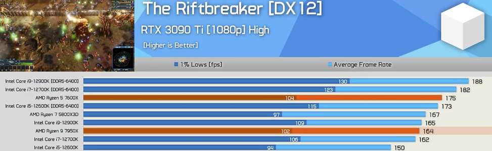

Threads jumping CCXs can be a major issue in gaming but it depends on which thread is jumping. Some threads for games are rather latency insensitive and don't need much performance, those can migrate just fine. However, if the primary threads (draw calls, game logic) get moved, you get big performance hits which result in things like the below. In general, AMD/MS/Game Devs have done a much better job in recent years of making sure this doesn't happen.
