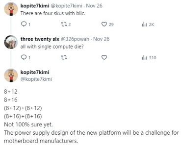

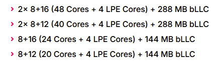

Top end NVL-S SKUs expected to get 288 MB bLLC (2x144 MB):
Then there's also this note:
"These chips will come configured with 144 MB of bLLC across each compute tile for a total of 288 MB cache. That's in addition to the L2 and L3 cache offered per compute tile, so the final number is going to be massive"
So apparently Intel is specifying it differently than AMD. Because for e.g. 9950X3D, AMD specifies it as 144MB, but that's the total amount of cache (128 MB V-Cache + 16 MB L3).
I'm wondering why Intel decided on 144 MB bLLC (not including Lx caches) though. Isn't it normally a power of 2?
At the lower level there's bound to be a building block sized to a power of 2, but the cache as a whole is more like a multiple of the number of cores within the chip. For example, in the case of ARL one needs to take into account the number of ring stops and multiply that by the the cache slice for each stop, which results in 36MB (12 stops x 3MB per slice).
Taking that into account, 144 is 12x12.

It's 8 stops (one per 2x P-core, one per 4x E-core) with 4.5MB per slice for the regular variant and 18MB for bLLC.
So for the non-bLLC variant of the NVL-S 8P+16E compute tile, there will be 8x4.5MB = 36 MB of what, e.g. L3 cache?
And does it mean the bLLC variant will have 36 MB (L3) + 144 MB (bLLC) = 180 MB in total per compute tile?

bLLC is L3
But maybe they got it wrong then?
Kepler_L2
Sep 6, 2020
1,074
4,596
It's not in addition, bLLC is just the large L3 version of Nova Lake

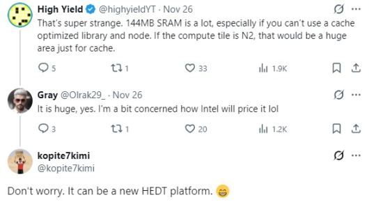

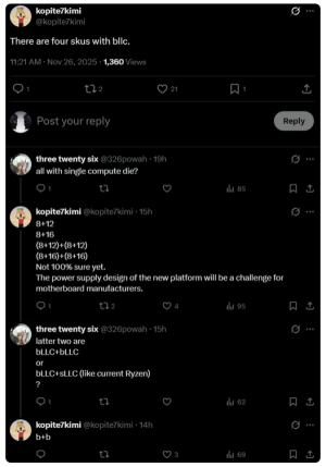

If this turns out to be HEDT Nova Lake, would be one of the greatest plot twist in speculation of past few generations of products
NVL-WS is a separate platform.
NVL-S has max 1 bLLC tile, even for 2t configs.
Same rules as AMD.

There is no need for additional CCX/CCD Cache it will not be any fast than single CCD
