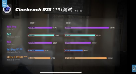

I am more curious about the instructions mix of CBR24 cause Snapdragon X2 is 162 on reference device kind of expected but M4/M5 is league ahead did they do something on it for cinebench?

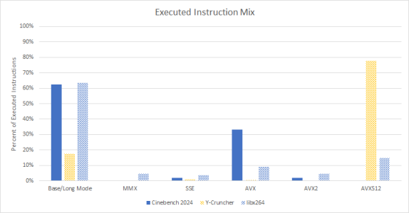

Here’s your answer
“Cinebench 2024 uses scalar and 128-bit packed floating point operations. Wider vector execution units are not useful. Scalar integer performance plays an important role in keeping the FP execution units fed.”

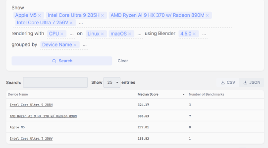

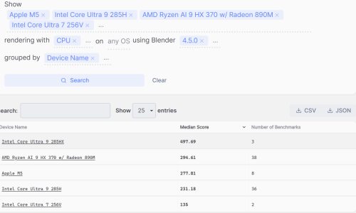

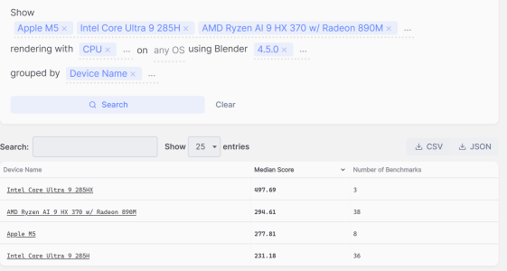

CB2024 is fine, its nT results reflects in Blender too
Ever since M4 Apple just went crazy with FP.

Here’s your answer
it is for x86 not ARM also Glymer is close to Apple M5 in ST but in Cinebench it's like 20% difference.
poke01
Mar 8, 2022
4,885
6,225
It’s the same for ARM lol. It’s scalar integer based.
Well like I said before Apples cores are very good at FP, which is what rendering applications like. They are also much wider cores than Qualcomms.
In R23 ST, M5 is 5% faster than the 285K at 5.7GHz with 8400MT/s CUDIMMs where it runs under x86 emulation. Remove the emulation and it’s not suprising to see the M5 doing so well in native apps.
