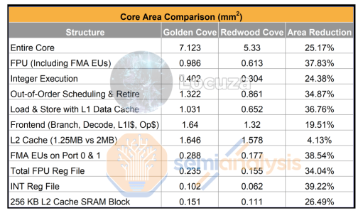

RWC is 5.33 counting 2MB L2 without SRAM it is 3.752mm2 on Intel 4.
Zen 4 is 3.84 mm2 with 1MB L2 on N5https3A2F2Fbucketeer-e05bbc84-baa3-437e-9518-adb32be77984.s3.amazonaws.com2Fpublic2Fimages2F11...png

Zen 4 is 2.56mm2 without L2. RWC is 50% larger at practically the same performance.
Also, Zen 5 is 2.7mm2 on N4 while Lion Cove is 3.4mm2 on N3B, the densest version of N3.
LNC Doesn't have HT btw RWC Does
