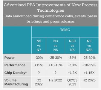

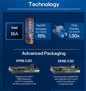

I don't think 18A is cheaper than Intel 3 but Intel 7 really pushed using multi-patterning while 18A uses more EUV steps than Intel 3 and cancels out some of the cost increases due to PowerVia.
18A is basically Intel 3 with PowerVia and RibbonFET. I'm expecting almost no optical shrinks.
They answered it in the earnings call and with Which we can estimate 18A wafer price they said 3X ASP vs Intel 7 wafer which is same amount as TSMC N7 Wafer as they are reporting it.
You are wrong though about optical shrink their own data says 1.3X Chip density same shrink Tsmc got out of N5 vs N3E.
That's exactly what they are referring to. They are getting 1.3x density with PowerVia. There's no real optical shrinks coming, hence why they are thinking of complementary FETs and stacking dies and wafers.
If they got more than 1.3x they would say it. It's a marketing presentation.
@Hitman928 The whole point was that Intel 7 to 18A wouldn't save costs, and I'm saying that's not the case as Intel 7 uses DUV with multi-patterning and 18A saves some by using EUV. Thus "countering costs of PowerVia".
I suspect you are right about BSPDN being the cause of the 1.3x number.
Until Intel moves to High NA, this will likely be the case. So with that in mind, TSMC's A16 (N2 with BSPDN) should provide a healthy density improvement as well ..... correct?
Still, Intel can make more density by doing more EUV multi-pattern passes. Of course, this lowers yield and increases process time (through put goes down) .... which makes the process EXPENSIVE.
You never get something for nothing in engineering ;).
With 14A which is coming 2 years after 18A they said another 20% density gain, with 15% perf, so High NA is further proof of more work for less gain. Future process gains are absolutely crashing to the floor.
There never was real any chance of the general transistor structure reaching 1nm size, nevermind one made of several Atoms. The real limit is around the 10nm range, and it's coming only with extreme amount of effort and money.
An hypothetical future computer that is a revolutionary advancement such as with the first computer is likely going to be a great shift similar to going from x86 PCs to ARM Smartphones. It will likely not be directly portable between each other.
Agree. With each new node we will continue to see less advantage, longer and lower yield processes, and more expensive development costs.
As for the discussion that CWF is delayed due to packaging, packaging may well be the next frontier!
It could easily be a bigger differentiator than the lithography process moving forward.
If you mean the pitches than I can't say for sure cause the data on 18A has not been released yet.
Yes
While 18A may be costlier than Intel 7 the ASP Difference is 3X so it more than offset the cost.
N3E -> N2 is 1.15X density improvement brought by GAAFET majorly and N2 -> A16 is 1.07-1.1X density increase due to BSPDN that is near the 1.3X gained by Intel with a combination of GAAFET+BSPDN.
N2 is EUV Multipatterning as well though.
Reactions: OneEng2
