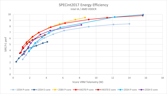

IMO the biggest thing Intel needs to improve is the L3 latency (on top of the memory latency, they seem to be at) which is 80% higher than on HX 370.
At the 8 MB test point, the delay of 255H reaches 75 cycles, close to the 81-cycle of 155H, which is much higher than the 59 cycle of 258V and the 45 cycle of HX 370. Although the 255H has much more L3 capacity than the HX 370, its access to the L3 is 80% more expensive than the HX 370
not holding my breath though ...
Lion Cove does have a larger L2 and an extra L1.5 cache. Those differences increase the L3 latency but reduce the performance impact from the higher latency.
AMD's cache setup is definitely better overall, but that 80% isn't apples to apples.

I really do wish there were some reviews that tested "CCX" power of AMD and Intel chips too for 1T and nT benchmarks. Considering Intel's much slower L3, and also larger core private caches, I suspect this would shift the power curve slightly more in Intel's advantage, though I suspect AMD would still have a large advantage despite that.

Is LNC too "wide" of a core for N3 though? Zen 5 is built on a N5 class node, with better perf/watt than LNC across the curve. I think they could get another tock out of 18A without shifting the perf/watt curve too much to the upper right and have a regression at lower power (cough RKL cough). If they fix their physical design too.
It matched Zen5 in David Huang testing with LNC in LNL vs Zen5 in strix Point with the horrible uncore of MTL/ARL the core suffered quite a lot .
