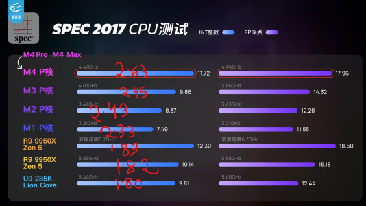

It will be around 20% if you factor the OS but Nova Lake P core should be at least 20-25% ST Improvement considering they will fix their IMC/Mem controller along with APX and additional changes.Also they are doing a Tick and Tock so it is to be expected otherwise I don't know what would happen to x86
IMC / Mem controller will help in lots of thing, but i doubt it will make a dent in the SPEC scores (improvingL2 / L3 cache though might). APX same story. Useful but won't move the needle in SPEC.
I wouldn’t put much stock into Geekerwan SPEC tests. Wait for David Huang.
Yeah, makes sense. Weren't they the ones to compile SPEC FP with AVX off?

M4 is what like 7-8% IPC Increase everything else is just Clocks and Clock scaling is pretty good in everyday applications

If they can get 30-40% ipc over skymont at >5Ghz by late 2028, then no... Two 15-20% jumps in 4-5 years isn't completely outlandish, NovaLake E core is probably halfway there already. Apple has been quite stagnant in iso clock perf, M4 is what 15% better than M1 at best? Intel doesn't have to beat apple either, just be competitive vs Oryon, Cortex and rumored Nvidia custom IP
Apple has been using part of their transistor budget into clocking the CPU higher, not just on increasing IPC, so it doesn't make much sense to only talk about IPC, what matters is performance, including clock speed.
Now that Apple is approaching x86 frequency, it will be interesting to see what happens, if Apple indeed has hit somewhat of a wall in terms of IPC AND frequency, or if they can still get solid gains, but as it still hasn't happened, one cannot say there is a wall already.
You are talking about 30-40% IPC improvement at >5GHz by late 2028, so 4 years from now. You can check the performance difference between M1 and M4, exactly 4 years timeframe, and you will see that it's higher than 40%.
Now that Apple is approaching x86 frequency, it will be interesting to see what happens, if Apple indeed has hit somewhat of a wall in terms of IPC AND frequency, or if they can still get solid gains.
For frequency they have been relying on Nodes more than their Arch
That's only part of the equation, though, for example, M4 P cores use higher performance libraries, less dense, so that's transistor budget that could've been used to increase IPC instead if dense libraries would've been used.
