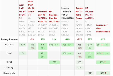

Here is a review of Acer Swift Go 14 SFG14-72 -> Notebookcheck.net
Didn't show any advantage against HP pavilion with 7840U, which had very similar config(display, RAM, SSd, battery, etc).
Even the other Acer Swift with Raptor U + 16GB + 512GB showed only a bit worse Wifi endurance than this MTL despite having smaller battery.
MTL has a higher sustained power limit of 45W, but that shouldn't matter during a wifi test in my opinion.
So where is that great efficiency during light loads? Is this also because the wrong bios is inside?

The idle power readings in that NBC review weren't too hopeful either but I think we're going to have to wait for software to mature a bit before we come to a final conclusion. The waters are just too muddied at the moment for anyone to come to a rational decision.

That great MTL efficiency is entirely masked by the abysmal efficiency of the OLED display. The review even says as much, "According to our energy measurements, it's the OLED panel that uses the most power when surfing."
And comparing to the RPL variant of the same model seems like it should be a fair comparison since it's even the same reported part number on the display, right? But it's clearly not the same display given the 391 cd/m^2 brightness on the MTL device compared to 279 cd/m^2 on the RPL variant.
Now in terms of judging a laptop their methodology is perfectly sound. It just can't be directly used to judge an individual component within that laptop. (Would be fun if they provided average CPU package power reported over the entire battery life test, but obviously they don't.)
They didn't mention at what brightness it was tested, but It wasn't at max brightness. They mentioned that only under full load.
There is still that HP Pavilion with OLED. It has comparable brightness and actually higher refresh rate of 120Hz. I think there shouldn't be that much difference.
Notebookcheck doesn't do bad reviews, but some things should really be more detailed.
In general I'd say their reviews are excellent, they're just focused on the device as a whole. Which is generally of greater interest to readers. It'd just be nice if they went into greater depth on the initial review of a new processor/graphics card release.
Anyway, their standard for battery life testing is 150 cd/m^2 unless it's noted as min/max brightness. But even then comparisons can't be made. The difference in maximum brightness is indicative of different panel/driving circuitry. The display in the MTL variant could easily be a constant 1W higher power draw than the RPL variant, we have no way to know. Similarly, despite the higher 120Hz refresh rate of that HP Pavillion the display may be using less power. Makes no sense right? That's the current problem with OLED screens on laptops. Some are abysmal, others are on par with IPS. The easiest comparison points for abysmal examples are on Lenovo Thinkpads, eg 5 hours for an X1 Carbon gen10 with a 2880x1800 OLED compared to 7.5 hours on the X1 Carbon gen9 with 3840x2400 IPS.
Assuming the OLED display is consuming something along the lines of the curve represented here - https://arstechnica.com/gadgets/2023/04/oled-is-great-but-where-are-all-the-mini-led-laptops/4/ - then at 150 cd/m^2 it might be in the range of 5-6W. Out of the average 8.14W the device would be consuming to arrive at 479 minutes of run time with a 65Wh battery. And the CPU is only part of that remaining 2-3W.
Power comsumption with the OLED screen off is 8W, for the 7840U Pavillion it s about 6.5W on average, numbers are here, it s just a matter of spoting them...
So it appear that when idling MTL is not that efficient, its idle power is 1.5-2W higher than the Pavillion and the OLED screen has nothing to do with it.

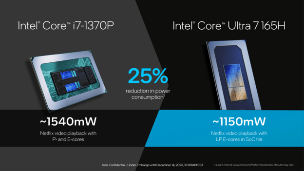

Idle and light load power is probably the strongest feature of MTL.
There are some issues currently with FW and OS scheduling which result in sub-optimal use of the LP E cores but this test does show the potential in idle and low use situations. This system here has a 120hz OLED BTW.

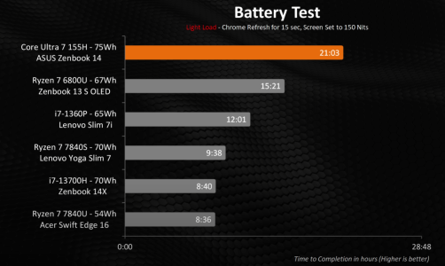

If MTL was as efficient than in this graph NBC would have measured better autonomy, even if only 30-40% that what they got.
Guess that to get those times they did set a convenenient corner case where only the LPE cores were active with a purely HTML page displayed if not a blank screen...
Anyway the idle values measured by NBC do not match those surprisingly favourable numbers, most likely that they are more or less made up..
Edit : Here the most favourable case i was talking about, and even in this exemple improvement in respect of RPL is 33%, not 90%, when that really happen because just a tiny more activity will wake up the biggest cores :
Power consumption as measured at the AC socket, yes. So including AC to DC power adapter, battery charge maintenance, etc. Simple fact is that without a power trace of CPU package power no definitive conclusion can be drawn regarding MTL efficiency versus entire laptop efficiency.
