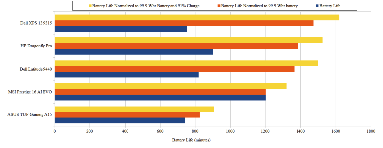

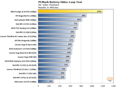

Here's the Hothardware chart normalized for battery life with and without adjusting the non-MTL laptops for 91% charge (not sure which is accurate). I only did the top 5 as I didn't want to spend a ton of time looking up all the battery sizes but as you can see, the MTL laptop goes from 1st to 4th out of the top 5 when normalizing for the size of the battery in each unit. This, of course, doesn't account for other variables between the laptops.
Original Data
My chart which includes normalizing to the MSI Prestige 16 AI EVO battery size.
Edit: fixed MSI laptop not properly normalized with the 91% calculation.
FYI, you went the wrong way with the 91% charge calculation. That would decrease their relative advantage compared to the MSI Prestige 16 AI EVO, not increase it. eg, with the HP Dragonfly Pro the calculation is (903/64.6)*99.9*.91 = 1270. Also of note is that the MSI and Dell Latitude are 2560x1600 displays rather than 1920x1200.
No, the 91% charge calculation is normalizing them to 100% charge, assuming they had a 91% charge in the Hot Hardware test. With that said, I forgot to normalize the MSI result to 100% as well, I will fix that.

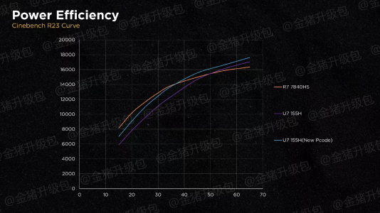

the sustained results improvement at 28 watts suspiciously match this graph:
Default behavior is to charge to 100%. They made a specific note in that review that MSI configured different than default behavior resulting in a start of test charge level of 91%. Which is actually a great thing that more manufacturers should be doing as keeping lithium ion batteries at 100% charge level when plugged for long periods of time is worse than 100 -> 0 -> 100 charge cycling. But they don't... Why? Simplest explanation is planned obsolescence.
Roughly 12K for 28W should be accurate for the updated pcode, I guess it's included in Bios 203. I'm curious how it will affect the game benchmarks which he wants to update as well. Maybe it won't change but this needs to be tested. They still have to fix the low power issue below 25W.
Here is the quote
The battery was only 91% charged when we started the test due to Windows' battery protection mechanisms.
That curve is bs, it s just PL2 that is increased to boost the score.
In the new curve we can see that from 20W to 40W the score increase from 9500 to roughly 14500, that s 61% higher perf for 2x the power and that s just impossible by the very laws of semiconductors physics.
61% higher perf require 3x the power with a very good process that scale close to a square law wich is the theorical best case for mosfets, so this curve is just made up, anyone with some knowledge of electronics will spot such a discrepancy.
There was a scheduling issue in the old pcode, you are wrong. You can see this also in the updated ultrabookreview Cinebench scores where it scored 12.1K after 10 Minutes at 28W.
No, it's quite possible and doesn't violate any laws of semiconductor physics.
The 7840HS result in that graph goes from ~8k at 15W to ~13k at 30W. That's also roughly 61% increase in performance for 2x the power. And those data points match up with other reviews.
With respect to semiconductor physics, keep in mind that power is linear with frequency and squared with voltage. So it's expected to have closer to linear scaling at lower power levels where the percentage increase in voltage is smaller for a given percentage increase in frequency.

Correct. And if you look up what Microsoft has to say about Window's battery protection - https://support.microsoft.com/en-us...-windows-2ac1b4ba-6027-410a-b80e-f6767d867002 - it's entirely dependent on the manufacturer to implement. Hence both assumptions that it's enabled by default on all laptops and would result in the same 91% starting state of charge are incorrect.
I never said that all of the laptops tested were at 91% charge. I said it was unclear, which, unless we know if each laptop is using smart charging and how it's configured, it is still unclear. That's why I did both so the info is there both ways. It's possible some of the others were even less charged than the MSI laptop, I have no idea. If someone wants to spend the time tracking down each model's configuration, I'll gladly adjust appropriately. Otherwise, the data is there and the comparison will most likely fall between the MSI only being normalized from 91% to all of them being normalized from 91%. The only thing that really changes is how close the MSI gets to the top 3.
UltraBookReview updated pcode and got a result that's nearly the same.
The curve on the old pcode went from 7900 -> 13500, which is roughly 70% increase. If anything, the slope becomes less extreme with the updated pcode.
