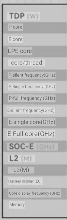

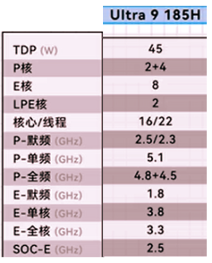

Can anyone here read Mandarin? What does it say before GHz there?
My assumptions:
Base speed of Level 1 P-cores (two in number): 2.5 GHz
Base speed of Level 2 P-cores (four in number): 2.3 GHz
Maximum Turbo boost speed of any P-core: 5.1 GHz
All-core speed of Level 1 P-cores (two in number): 4.8 GHz
All-core speed of Level 2 P-cores (four in number): 4.5 GHz
Base speed of E-cores: 1.8 GHz
Maximum Turbo boost speed of E-core: 3.8 GHz
All-core speed of E-cores: 3.3 GHz
It seems that Intel is unable to hit 4.8 GHz all-core frequency on the P-core cluster, either due to Intel 4 process immaturity or not enough available power.

Google Translate says:

That's correct. Ultra 9 has much higher clock than we expected..

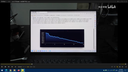

Here's the review of retail version of ZenBook 14 OLED in China, seems like retail version is having lower thermal tolerated version as you can see from picture below:-
Gaming performance is more or less similar to 780M...
28,173
19,203
This is Core Ultra v0.9
It will take them a year or two to solve the thermal tolerance issues and get reliably high boost speeds like Raptor Lake.
