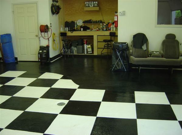

Looks great OP. Don't skimp on sealant for the floor, though. Mine has already survived some really nasty drops and spills, and it's none the worse for wear.
http://i217.photobucket.com/albums/cc99/magick72/garage003.jpg
I went with J&S, great product and company. http://www.vortexsprayonliner.com/article/4/floors
I'm really indecisive about what I'm going to do for the floor. The short term plan is "nothing" but when I get serious about a project car I'll make a decision.
The next repair I'm doing is a new passenger side mirror on my Grand Marquis. After that is 100,000 mile maintenance on my wife's car. I'll do the floor before I get a lift, build a '32 Ford, or LS swap into something.
