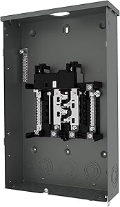

If I built up my own assembly, is this a good start?
I can get one of these reasonably.
The load lugs are rated for multiple conductors.
Put that in the middle on the cross struts, and then what would be a good choice for the disconnects?
Use the side knockouts and connect with short nipples?
A couple of "trailer park" load centers?
