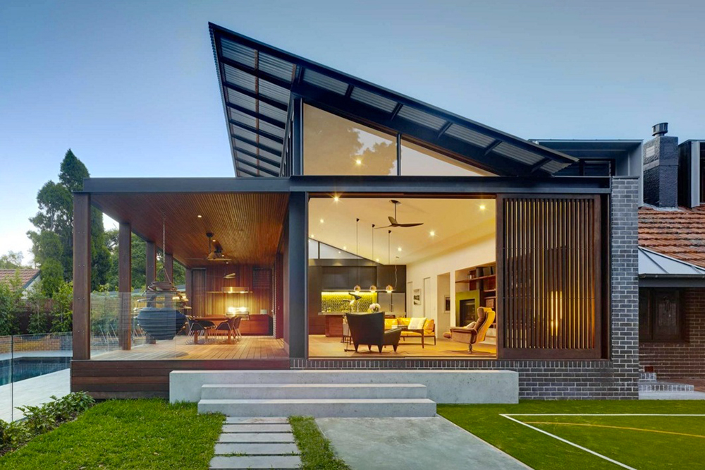

single pitch roofs, very inexpensive to build. Quite low pitches, metal roofing, and TJI rather than trusses.
This is not representative, but the roof facing to the right is probably even steeper than our high roof will be.
There are windows facing to the left under that overhang. Those are clerestory windows.

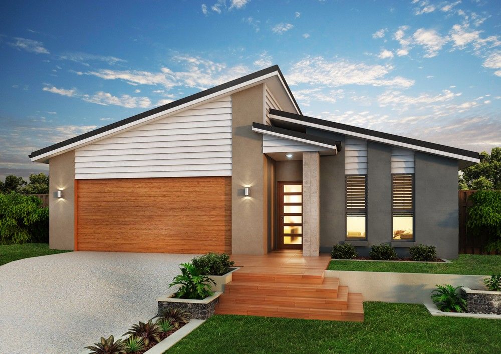

Here is another example, a little closer but no clerestory windows. I did not know, but these are skillion roof lines.
Ours will face like that, and the windows will face east to let in the early sun. In the summer the 3' overhang projecting over that row of windows will keep out the direct sun for passive cooling. In the winter the lower sun angles will provide more light.

The roof will really be like that second picture, only more overhang. No little bullshit porch roof.

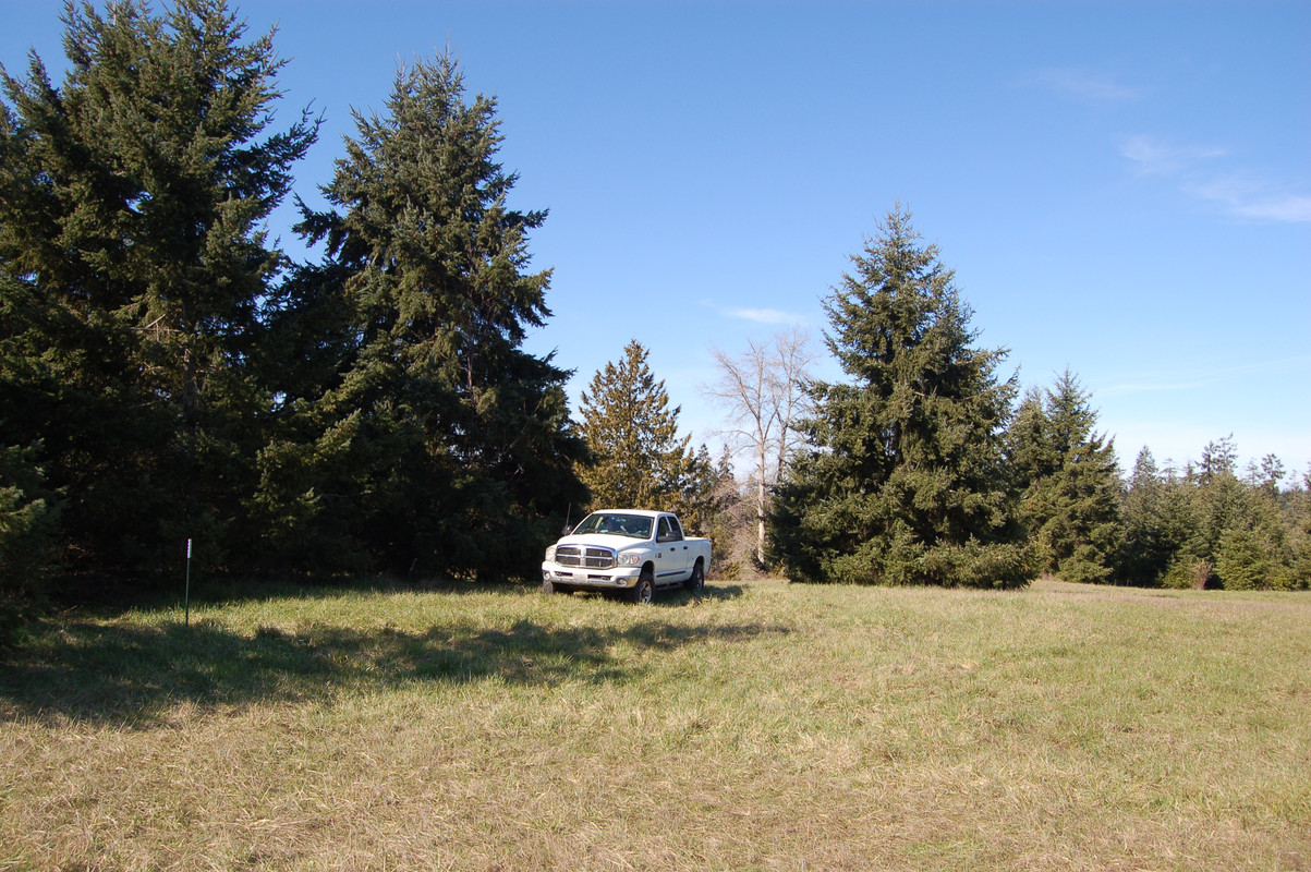

To do it right, I have to cut down some of my favorite trees argh.
The house will be where the truck is, the trees to the left of it have to go. The tree behind and to the right and everything else stays.

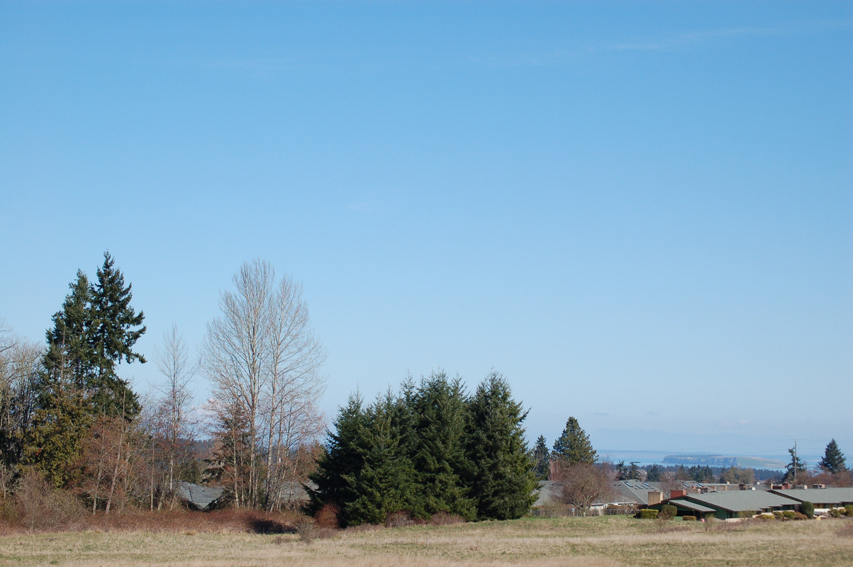

We finally got to see Mt. Baker, and also see that our view was blocked by trees LOL! At first I was all GAAAH! then I realized the developer next door would take those trees down, thank you very much :D

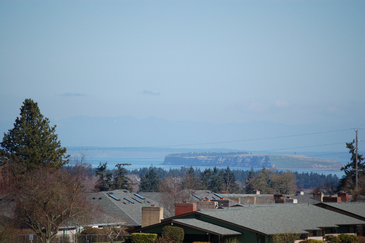

There it is, hiding in those deciduous trees on the left. Views of Protection Island, Eastern straits of Juan de Fuca, Whidbey Island and the north Cascades. The mountains will pop on the less hazy days.
We can see some peek-a-boo views south of nearby Olympic peaks. The lower half of the property has some snow views to the western foothills of the Olympics.
That was tempting, but I think that part will have less winter sun.

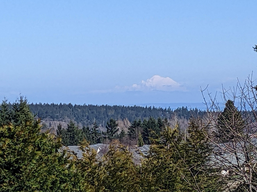

If they do cut those trees we will have a similar view of Mt. Baker. This is from the neighbor's deck ~25' above our property.
