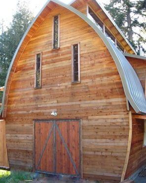

Check out these clerestory windows they tossed out there. Pretty cool, not exactly what I was thinking but I like it nonetheless.
These are shed dormers, and probably what I will do for windows. Not exactly these but you get the idea.

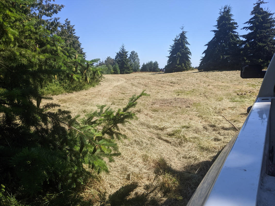

We got up there to mow the grass and knock down some trees on the access. You can see a before picture from two weekends ago above.
I have to do some limb pruning from the truck bed and then I can get the travel trailer or dump truck up there without rubbin'.
Looking onto the upper area from the same spot, after much mowing:
Looking north, east fence line to the right. That tree on the right is on the property.
