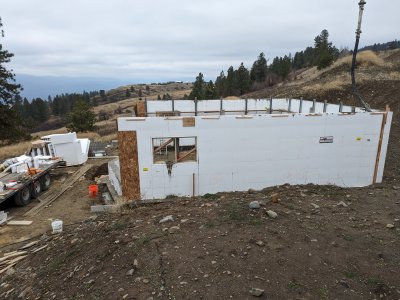

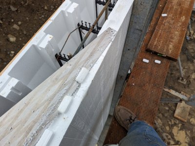

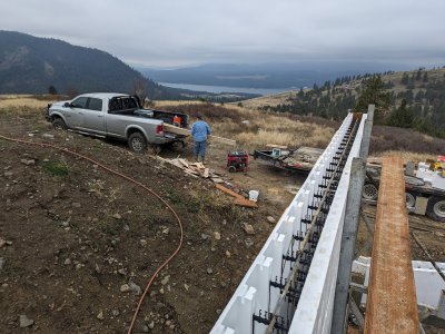

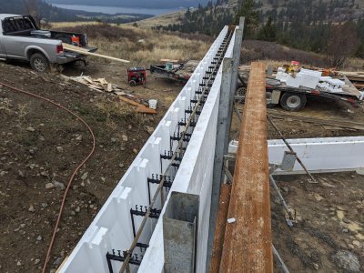

My friend got his footings poured and then he's single-handedly stacked the ICFs.
I played hooky for one day from work and I went over to help him pour the walls.
