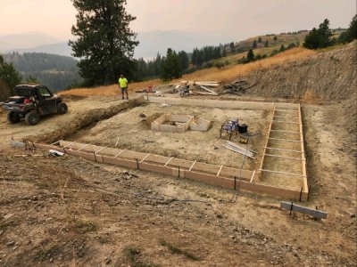

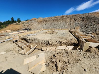

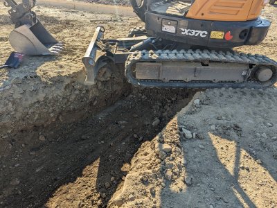

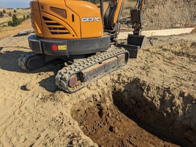

I got his footings excavated today.

Edit: the footings are fabbed up and waiting a new rebar and stemwall design for ICF.

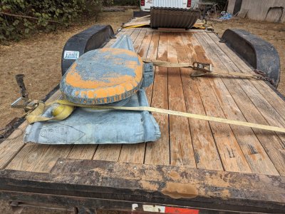

While waiting for the permit my brother and I took an epic road trip to haul a backhoe to BF Montana and pick up a couple of grain bins for use as gazebos. I have a plan for one at the new place where it has a great view to the Olympic mountains to the west.
it is a 14' diameter bin, made at US Steel Gary tin plant in 1963.
I am kicking around the idea of making it half open, with a solid back to turn to the weather. Also building it tall enough to have a loft for the nieces to use for camping out.
I have the rotech bearing from the 28,000 pound excavator to use, and I might make this gazebo rotate as needed. I also have 2x6 channel steel from a job so all it takes is a little fab work.
My only concern with the loft idea is it may get a little tall in appearance. if you keep them low they look pretty good.

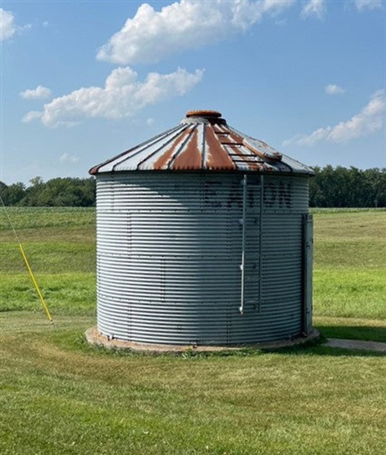

That's an 18' , ours is a little smaller.
Only $4585 at Etsy!
