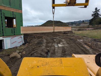

Special delivery. Having a telehandler on site is totally worth it.

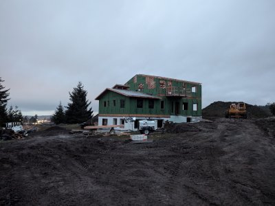

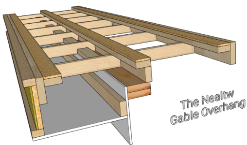

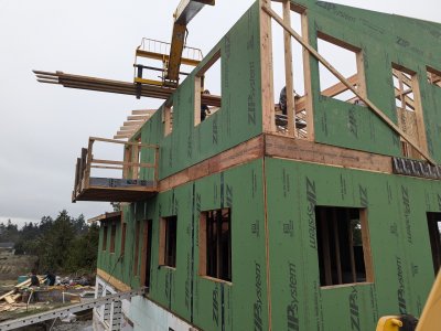

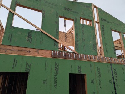

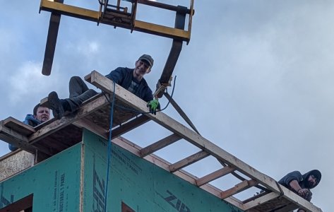

Fun times today. The master framer extraordinaire was building these outrigger ladders and we busied ourselves with fixing nailing boo-boos and patching in zip sheathing here and there while we waited on him.
Sketchup of outrigger ladder assemblies.

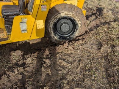

We got all the way around fixing shizzle and had this one really bad side left to do. I knew I'd be stuck as soon as I stepped off the good pit run fill of the carport, but we managed to get it pointed to where we could finish the work.
easy step up entry

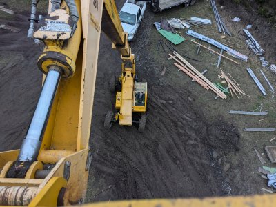

The 120 standing by for recovery.

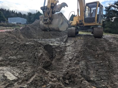

Interesting factoid:
at more than 22,000 pounds, the telehandler is only 5000 pounds lighter than the excavator. It was a bit of a pig to pull up there.

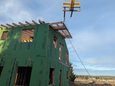

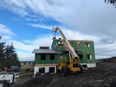

It went, not always smoothly but moving forward. This one we put up there to find that the adjacent joist was put on out of schedule, so I parked it there against the wall while they fixed that.
The long two are done and we have one built for first thing. I'll bring up 3 boxes of the pit run to build a launching pad for the NW corner unit.

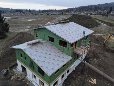

Roof is about done, two rows of sheeting left for the morning and the top of the cupola there.
Reactions: iRONic
skyking
Nov 21, 2001
22,877
6,044
Dried in!!
Metal roof is two weeks out, windows are 3 weeks out. We are doing punch list and interior walls the next two weeks and take a break. I already lifted the foot off the throttle.

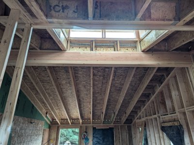

Standing in the first floor main ensuite bathroom.
Looking up through an imaginary interior window to the cupola above. That may be stained glass, it keeps changing.

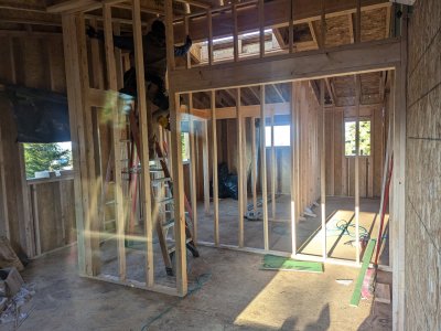

West wing ( our bedroom ) getting framed out. That is a pocket door header, think door on right and wall on left.
There are 3 pockets in that area that will likely not get closed in real life.
3 more upstairs.

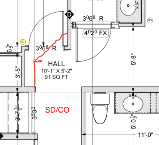

Today was the best so far. I'm standing in spaces and moving walls and generally messing with my framing crew. When you design a space on paper, you really don't have the feel for it like you do when you are in it.
I took a little more from the powder room for the built in cabinet for the fridge.
Then I looked at counter depth fridges and between those two things I made 6" more space off the end of the island, or a bigger island. Whatever we want to do at that point.
I am building the cabinets.
Upstairs, one of the framers snapped out all the walls as drawn and for the most part I left it alone, except for one glaring tight spot. I looked at that for about a minute and now that is a custom angle that they get to figure out tomorrow. It opened things up nicely. We ditched that awkward notch on the left that the CAD guy made to get a 3' door.
went straight off that bearing wall, angled over and had plenty of wall for a 3' door and eliminated that choke point.
