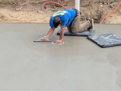

I had cut down all plumbing and conduit below grade so I could get a great finish. Here is the guy hand troweling around that floor sink, his hand is on it and it has 1/4" plywood on it still.
The water heater sits about where he is.
