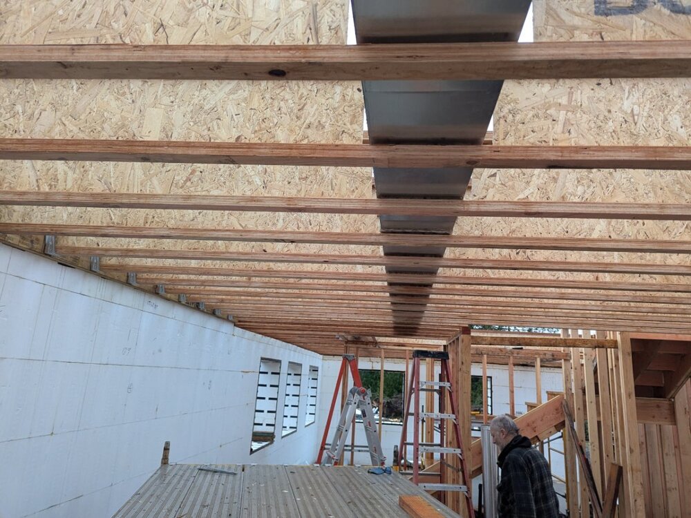

When I got this plan going, I set a goal of not having any ducts or BS dangling below the floor system. What a PITA that has been! I've been learning sheetmetal along the way and did a 4" panel reducer on this bend, which required cutting the long way bend. I wanted stuff that just plugged together. No, Not so much.
That long run of holes is filled up now.
Not a fancy elegant reducer, just a dirty old end cap transition to 8" round. I will cut in a 6" to 3.25x14 wall riser near that area to get up to the sunroom on the 2nd floor. It is a bit locked in from other routes so I figured out a shortcut.

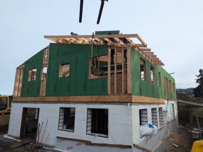

Moving right along. This end of the house is the main suite with vaulted ceilings to a 12' beam, and also a guest bath and our main floor laundry. Tomorrow we will build that last rake wall in two sections and set it with the telehandler.
That ballon framed rake wall is 22' or so high and we framed it that way because it is adjacent to the stairs. If we had framed it as two walls, it creates a hinge point with no support.
The 4x6 window is a fixed one for light down through the stairs and open elevator shaft.
That was all I could reach to set it.

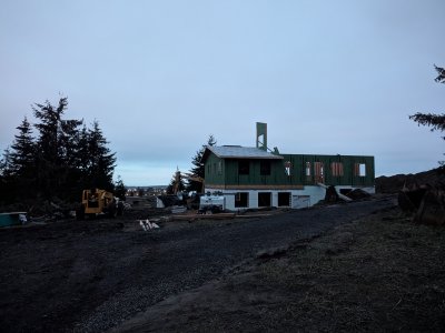

Other fun stuff. I have access to a nearby quarry and have been cleared to load my own material and write load tickets on Saturdays. The site is getting hammered with the telehandler, so I am patching it up with 3" minus crusher run rock. They used to have a 966 to load with, but now all they have is this 980. It is a bit big for the 12.5' bed I am running.

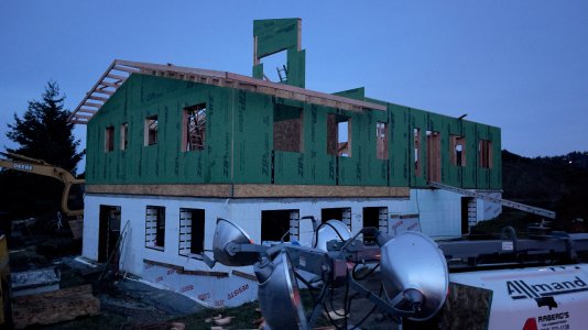

A week ago Saturday morning no walls, to Friday afternoon all the first floor bearing walls are up.
Pretty damn stoked about that! We got a few partitions in there as well. Joists are cut for over the west wing for Monday morning.

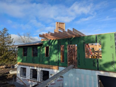

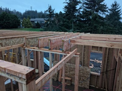

the framer built the lookouts as a ladder on sawhorses on the ground, then we set them in one piece with the telehandler. That was pretty nifty.
It has a 2x6 sub-fascia and is really stout. we are ready to dry the west wing in tomorrow.

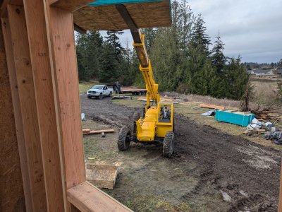

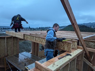

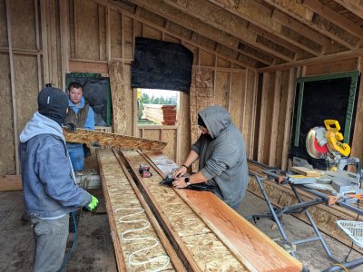

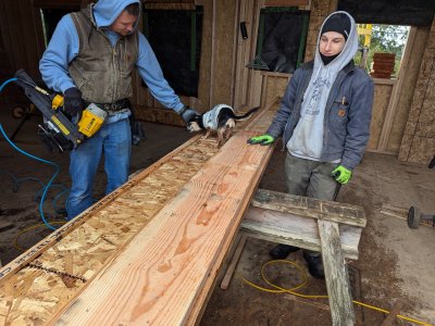

we have the balcony assemblies up. Those were heavy bastiges, 24' of 2x12 select structural fir, sandwiched to 19' I-joist with 5/8" web filler and a bunch of nails.
I single picked them up there with the forklift and a strap.
The balcony doubles as weather protection for the front door.
It rained pretty much all day and the guys set up an assembly line for the cantilevered walkway assemblies in the dried in west wing. I shot the 2x12's up to the window for them.
Daisy came down to supervise. She did not care about the nail gun noise, she wanted on that joist NOW!

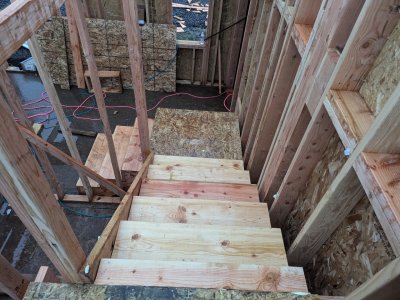

2nd floor framing is just about in the bag.
The framer has the stairs 2/3rds done.
This LVL had taken a set in all the rain we had. It went on OK except for that last little bit it was tweaked up 1/2".
I stepped on it and Brandon screwed it down from below. All better.
