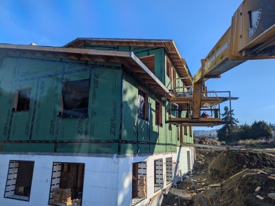

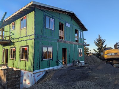

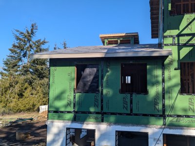

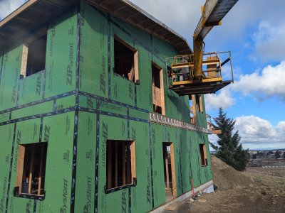

The zip sheathing is all taped and ready for windows, doors, siding.

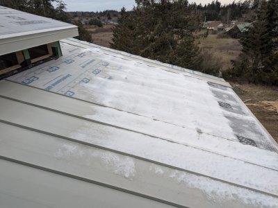

I picked up all the flashing metals yesterday and we have the fascia and drip edge on, ready for the roof metal on Thursday. That is the roof color there.
No painting that or the barge boards, ever.
I never had a chance to use the zip system. It wasn't readily available where I was working and didn't tie in with the existing 60 year old tar paper on most of my projects very well. It's a shame I'll be dead before the long term reviews come in.

a preference.
The cost is similar, but wrapping a two story over a basement excavation is really a PITA, compared to taping seams after the nailing inspection.

a preference.
OK, I guess that makes sense. I'm not a home builder, so my experience is very limited. I used Tyvek when I build my garage about 10 years ago...but that was a single story.
Zip sheathing gets you water tight quickly. With regular OSB or plywood you have to install whatever barrier your using to make it water proof. With some of those you risk them blowing of in the wind.
It's a slick system, it will be interesting to see how it holds up long term.

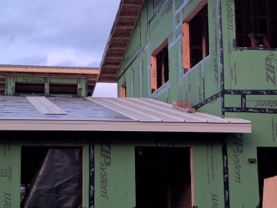

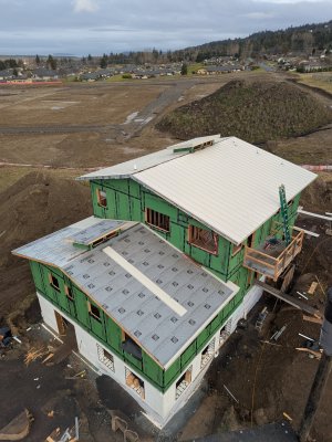

metal vendor showed up yesterday and ran off 22 squares of metal and brought some trim and screws. '
We had a big crew with two of my neighbors, we had put all our metal roofs on years ago. The framers. My brother and nephew.
We got a good jump on it and the upper roof is done sans barge and roof peak metal.

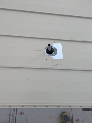

All the plumbing and two solar jacks are installed, the no caulk style that is shingled in there in layers.
Brother and I stayed on later and got the lower about 1/3rd done. Weather permitting, it will be substantially done tomorrow and ready for solar panels.

Over the years I've seen a few of those roof jacks leak because of minor movement in the structure/plumbing system. The pipe will move down enough to pull the boot down and creates a little puddle around the pipe that eventually drips into the house. An annoyance more than a problem.
They make a little boot that goes over the pipe and prevents that from happening, well worth the two bucks they cost. For the life of me I can't remember what they're called.

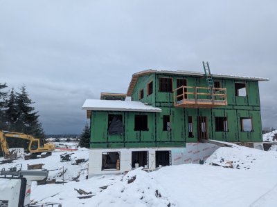

Mother nature has other ideas. We'll install windows while we wait for the snow to quit falling.
temps are below freezing every morning and I have no plans on skating down an icy metal roof.

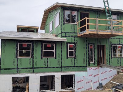

windows are installed.
We can do that south roof tomorrow. The north roof may take a little waiting. It is supposedly going to be warm enough to melt that ice off on Saturday.
