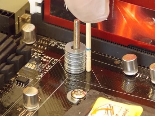

I figured for this test I'd have a little fun so I popped open my computer parts toolbox which has some grains of rice in it. What? Doesn't yours? 😛

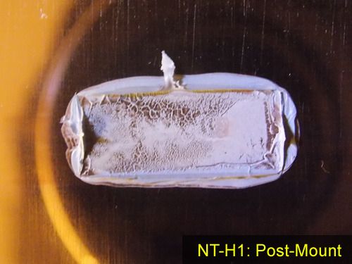

On goes the NT-H1 and a couple grains of rice just for demonstration purposes.
I know the internet lore is that we are supposed to put on "an amount comparable to a grain of rice", but in this case I put on an amount equal to roughly 3 grains of rice.
And the resulting mounting image?
Pictures of perfection if I do say so myself 😉 😀
And the temperature data were quite good too!
That's about 5°C better than my best IC Diamond results at the high end (4.9GHz).

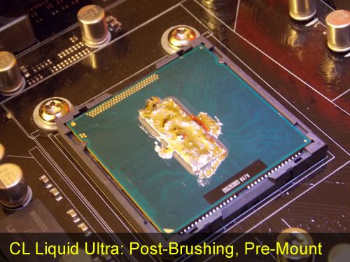

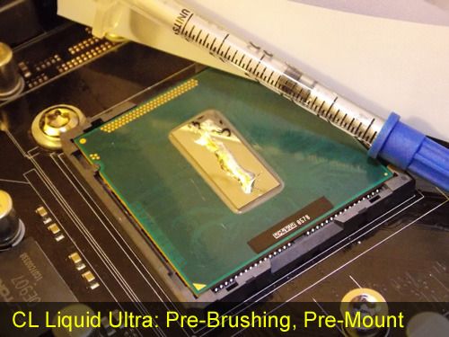

Applying Liquid Ultra is similar to applying any other TIM, you squeeze some out of the tube onto the surface in question.
There is one minor step involved, not sure if it is really required but I did it anyways, which is to use a provided brush to spread-out the Liquid Ultra prior to mounting the HSF.

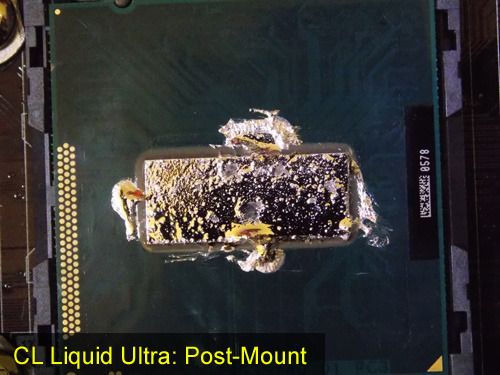

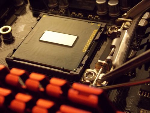

Here's what it looked like after I brushed the Liquid Ultra around on top of the silicon die:
^ the TIM looks brownish/copper in color in this image because it is actually much like a mirror and it is reflecting the copper color from the nearby H100 waterblock.

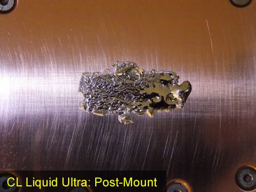

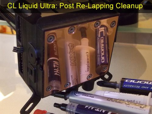

After the tests, unmounting the H100 to see the die post-mount:
(again, the brownish color is an artifact of reflecting the light coming off the copper of the nearby H100, the TIM itself is very much a mirror-like silver)
^ the imprint on the H100 is nice, exactly what you want to see. The Liquid Ultra remained confined to the area local to the CPU, it did not wick across the CPU PCB or the H100 copper surface.

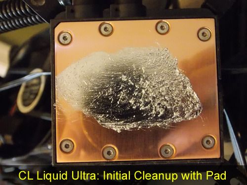

Cleanup was rather painful, to put it mildly. While all the Liquid Ultra can be removed, mostly, it takes a bit of work.
Here is what you get to look at as you start to wipe away the Liquid Ultra from the copper block:

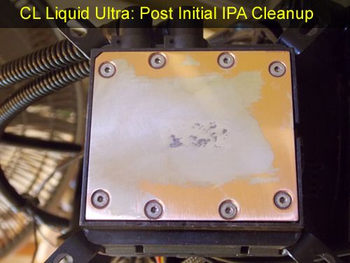

Further cleaning up the H100 with IPA and paper towels removes nearly all of the Liquid Ultra:

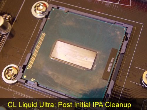

Same deal with the CPU itself, removing the liquid ultra was a complete PITA to put it mildly :/
Really laying into the H100 with IPA soaked towels and scrubbing the bejebus out of it resulted in the following:
^ the silver sheen masking the copper color is an indication of the fact that there is still a thin layer of Liquid Ultra adhering to the H100. The only way I could fully remove all the Liquid Ultra was to re-lap the H100 with 800 grit sandpaper (followed by 1000/2000/3000 grits).
^ boom, pristine H100 surface restored 🙂

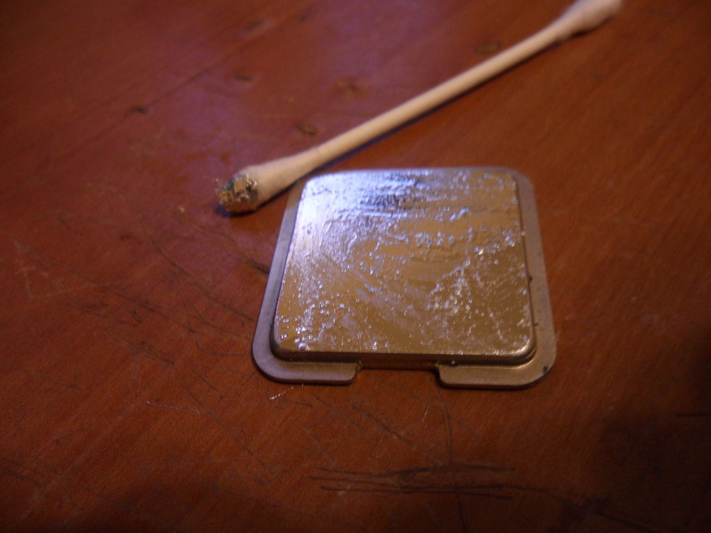

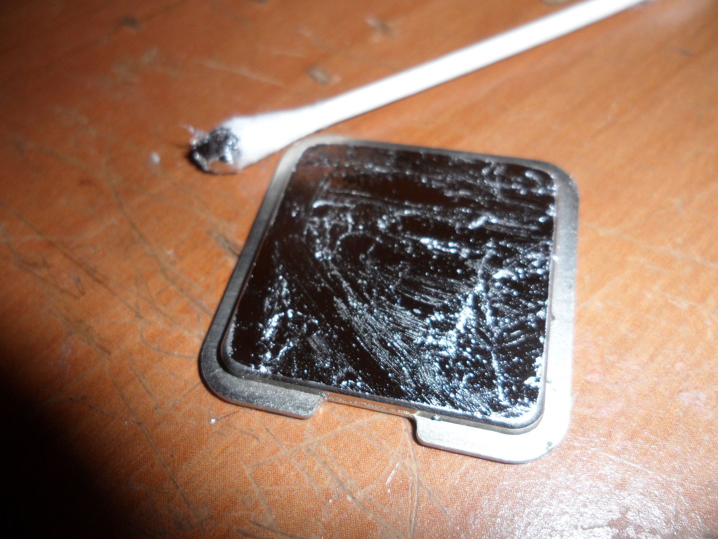

Removing the last remnants of Liquid Ultra from the CPU posed to be an even greater challenge because I couldn't fall back on using sandpaper to remove the remaining layer of TIM.
In the end my poor 3770k CPU didn't fare as well as my H100. Between the abrasion caused by the IC Diamond and the hazing (remnants of Liquid Ultra that could not be removed), this CPU is starting to look a bit worse for the wear. 😱
^ compare this "after" photo to the nice pristine surface I started with in the following "before" photo:
Like high-school prom night, sometimes the goods aren't returned to their owner in that original factory-new condition 😉

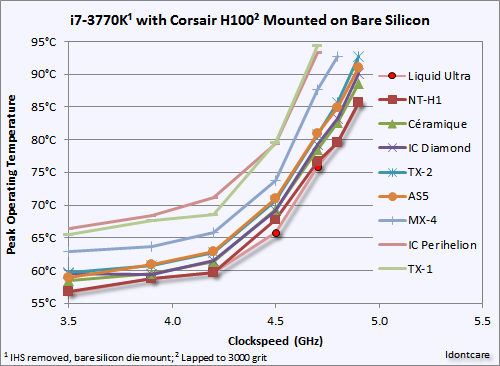

Pulling all the results from the nine different TIMs together, we arrive at the following table:
I rank-sorted the table from left to right in order of decreasing thermal performance. The closer to the left-hand side of the chart the better the TIM performed in the tests.
As others have noted, I am at a loss to explain why MX-4 performed so poorly in these tests. Out of disbelief I remounted and reran the tests multiple times and the results were repeated to within a degree each and every time.
The poor showing for MX-4 is either due to some unforeseen interaction with the silicon die of the cpu (not exactly the target application for MX-4 😀) or the rigorous thermal environment that is created by the much higher concentration of heat at the surface of the CPU die itself versus that of the IHS-to-HSF interface is highlighting what would otherwise be a very small performance delta between MX-4 and the other TIMs.
There are other possibilities too, for instance there is a chance that my particular tube of MX-4 (I only have one tube) is somehow borked.
However, in testing MX-4 vs. NT-H1 from the exact same tubes using the exact same H100 and same 3770k (albeit with the IHS still in place), the MX-4 performed just 1°C poorer than the NT-H1. They were practically indistinguishable in terms of thermal performance in that application.
So this tells me that these seemingly anomalous MX-4 results appear to indicating that MX-4 just doesn't react well to be placed in direct contact with a bare silicon die.
OK, getting back to the big picture view of the results here, perhaps a graph will better enable digestion of the results:
Note I intentionally zoomed in on the temperature axis to show as much differentiation between the various TIMs as possible.
Surprisingly most of the TIMs performed within a degree or two of the Liquid Ultra, although for some of these TIMs that result is the uninteresting one because we probably wouldn't want to use the TIM in this application anyways owing to the pump-out effect.
The two TIMs that would appear to merit use for this direct-die application are (1) Liquid Ultra, and (2) IC Diamond. Neither are expected to suffer from the pump-out effect and both provide excellent cooling results for this bare-die application.
Unfortunately there is a downside to both of these TIMs, when it comes to cleanup and removal of the TIM you are looking at a situation that is decidedly more challenging than that of your everyday TIM. Between the copper staining and gallium residuals, both requiring lapping to fully remove, and the irreversible alterations to the surface of the exposed silicon die, if you choose to pursue using either of these TIMs in your setup just be prepared to more or less live with things looking used in a way that you'd never expect to see from the other TIMs like NT-H1 and AS5.
That said, I personally feel the upside more than outweighs the downside and would not hesitate to use either IC Diamond or Liquid Ultra on my H100 or CPUs again.
I will most likely settle on using the IC Diamond for my long-term CPU TIM at this point in time just because it is not electrically conductive and the temperature difference between the two is not enough to make all that much of a difference in terms of power-consumption or overclock potential. Just a personal preference at that point, I can appreciate that others would choose differently given their specific situation and preferences as well.

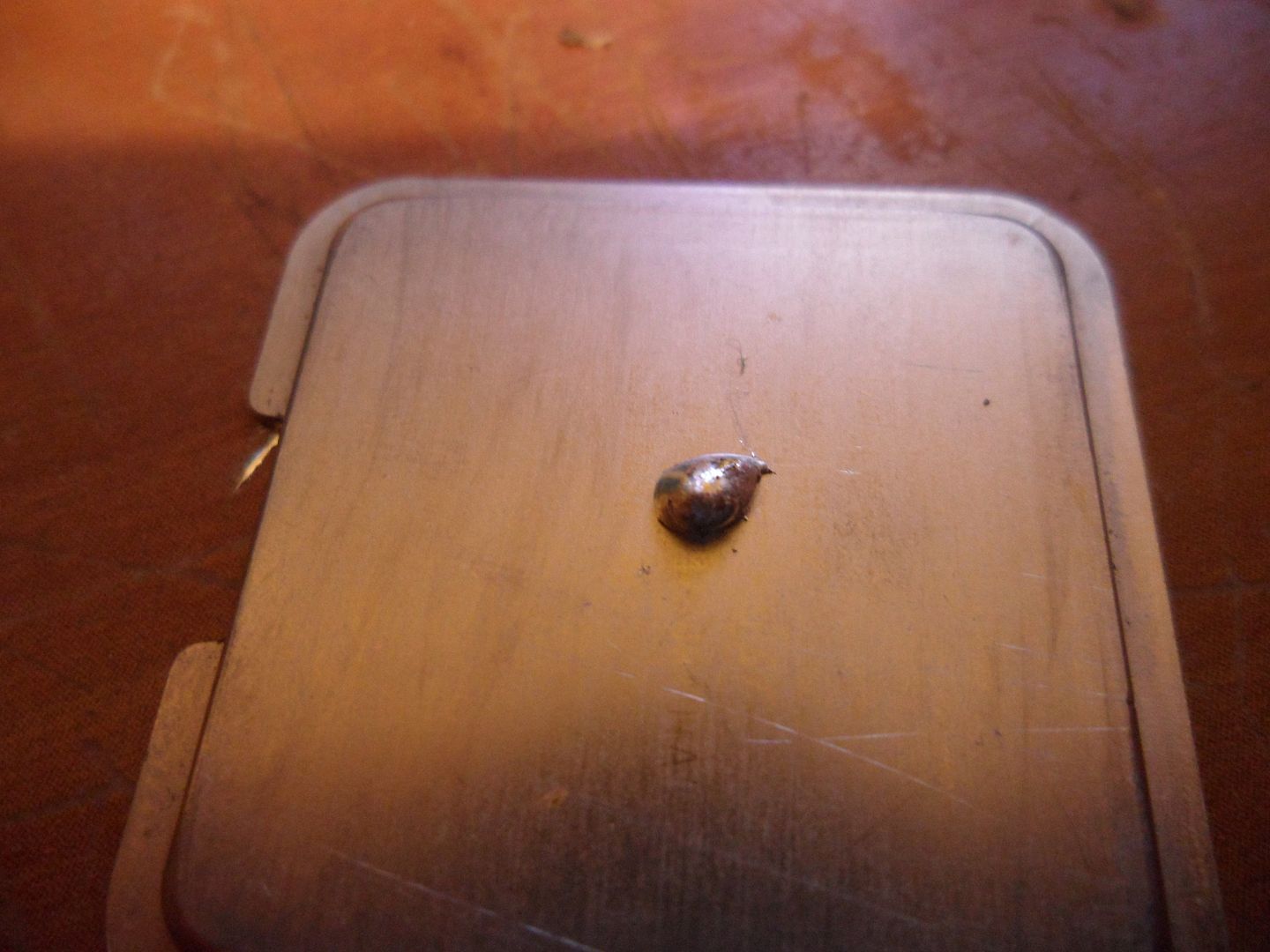

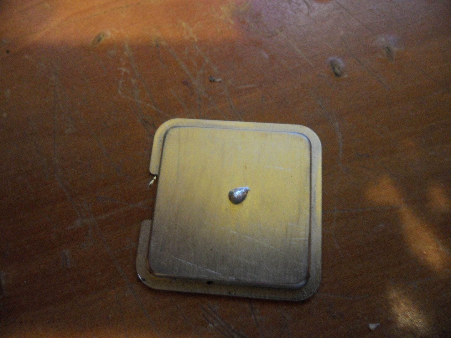

:twisted: I may have gotten just a tad too much NT-H1 on there 😀
LOL, I'll post up the results on this funny test tomorrow. Feel free to contribute your own bare-die results to this thread if you like. I'm curious to know if people have observed pump-out effect with Liquid Ultra, or confirmation that it hasn't been observed for x-number of months and so on.
You used to much Liquid Ultra Bro
use 1/4 of that and try again XD
Half a rice grain. <-- and i think that is to much.
Liquid Ultra is made to Spread does not work as well if u let it spread it's self.

I just took these pictures afew mins ago.. after i made the post above to show the amount needed to cover a Whole IHS.
Your goal is no puddles your trying to put on like paint pretty much.

I devised a simple tool for quickly verifying that the stacks of washers were indeed the correct height:
A toothpick which has been marked in blue to the desired height and washer count. With this handy tool I could quickly touch it next to each of the four stacks of washers and visually verify no stack was missing a washer or had too many washers.
Why didn't you use your calipers? Doesn't it have a pin that extends out as you increase the measurement? Use that part.
The second TIM tested was IC Perihelion.
What I observed in using this stuff is that it is akin to a thermal pad in a tube. This stuff is thick, viscous, not very pliable. It is kind of like putting a piece of cheese on your CPU in terms of consistency.
And not too surprisingly this TIM was the most difficult to get a good mount. It was very very difficult to get enough on the CPU so as to cover the die while at the same time avoid getting so much on the die that it would form a 1mm thick pad when I mounted the H100.
Sounds like Shin Etsu stuff. It is useful in some specialized circumstances where you don't have anywhere near a perfectly mating surface or a gap that needs bridging, but otherwise a PITA to use.
I had heard of the game "52 card pickup", and now I've played the game "50 washer pickup". Will not be making that same mistake twice 😡
How permanent is your washer setup? Maybe you can glue them together as a stack? Get your desired stack prepped in a clamp (maybe cover clamp in a plastic baggie) and then drip some super glue gel into it.
I'm kinda shocked it spread out so good....That stuff if pretty thick and kinda hard to work with from what I remember. Last time I used it was on my GPU water block a couple years ago....Seems to be holding up just fine to this day.
I've had a big tube of Ceramique that was super thick, obtained from someone else and not purchased new. I have also used new tiny tubes of the stuff that was much thinner. Made me wonder if the stuff thickened with age, or if they changed formulations over the years.

With the typical few C spread difference from this TIM to the "best" TIM, I decided I liked ceramique the best for it's ease of application, low cost and overall performance per $ spent.
