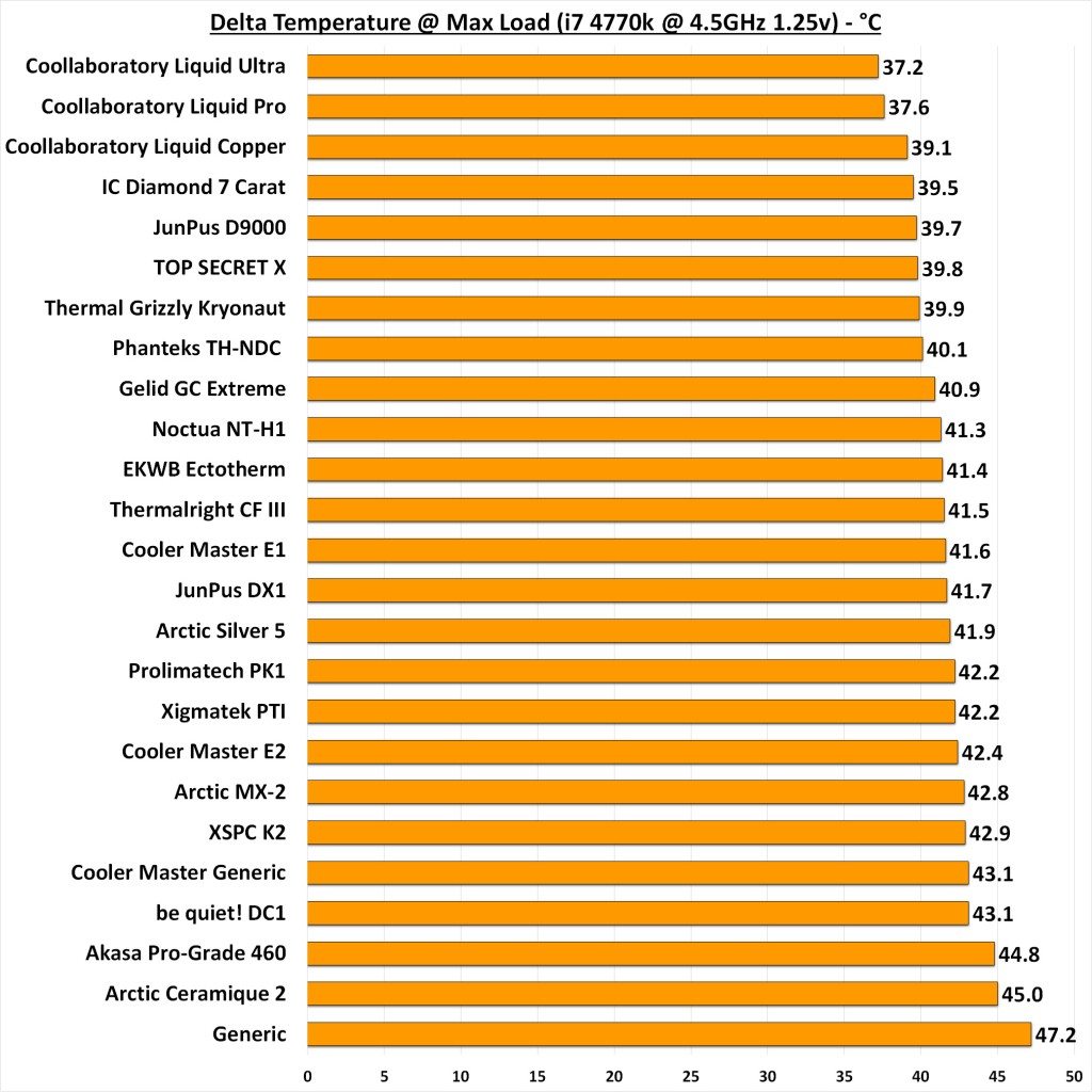

Does it worth to spend 15 € for a 5.5g syringe of Thermal Grizzly Kryonaut?
Probably it could be even more than 1°C difference from the Noctua NT-H1, at least 3°C I would like to hope.
nice graph
It's prolly worth it, the price seems comparable to others.
test it for us and let us know :)
I've always used AS5 myself without problems.

I've been using kyronaut as TIM1 on my Haswell for several months and the performance has only improved.
Much better than NT-H1 on the watercooled GPU as well (8 C rise vs 10 C rise).
Thanks for posting your experience. Unfortunately I'm not going to spend all that money just for 2°C difference for now, but who knows in future. I'd like to have temperature comparisons after 3 weeks, which are more significant in my opinion, since you never know how a new TIM performs over time. :)
Well, just saying that going from +10C to +8C is a 20% decrease in temperature rise. Scale as appropriate for your actual temperature rise in your machine...

If anything this topic should have shown that there is a difference between testing well, and reality. More liquid (less viscous) pastes might test better, because they spread thinner, but they likely can pump out and dry out easier.
These so called real-life testing conditions, aren't really scientific, because nobody can replicate them, not all information is shared or known: like the distance between plates, or the volume and mass of paste used.
Also long term testing isn't something that most testers bother with, even though one could return to the same PC every year so after cleaning it to record temperature creep over time.
Absolute physical parameters that would provide a real point of comparison are never tested i.e. thermal conductivity, viscosity (both hot and cold) and others.
