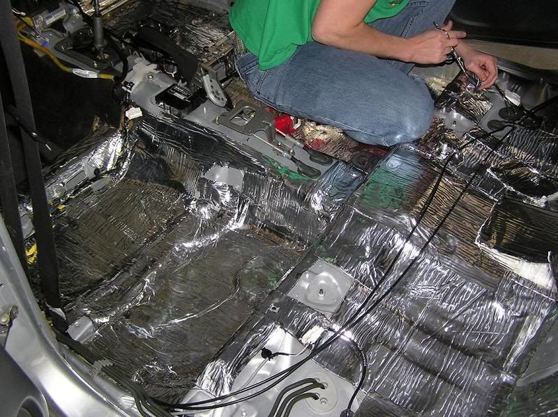

Originally posted by: Safeway
I do agree with your comment on sound dampening:
My WRX.
What kind of sound dampening are you using?
I'm using peel and seal from Lowes. NO JOKE. It works wonders. At the fraction of the cost compared to dynamat. So I've used two to three layers even.
My WRX.
Bulk dynamat I got for free from a custom installer.
