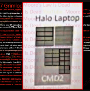

MLID showed 8 core chiplets that can be added to Zen 7 Halo. So, if these chiplets exist, then they would also be used in low end desktop.
BTW, this strategy of AMD of having "Halo" product and not pairing them with V-Cache chiplet is a head scratcher and an opportunity lost.

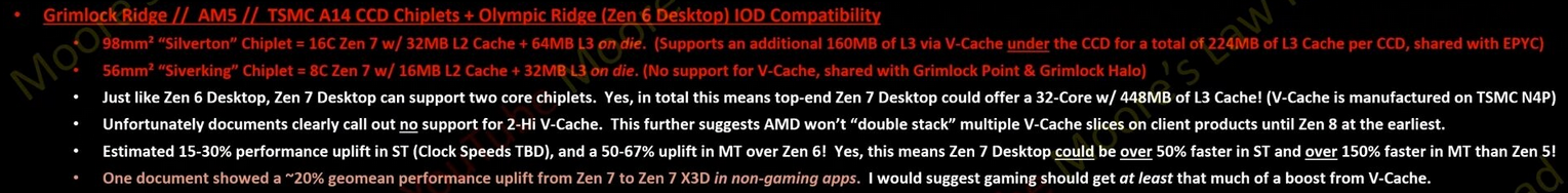

Also from that slide:
Which says: "No support for 2-Hi V-Cache. This further suggests that AMD won't "double stack" V-Cache slices on client until Zen 8 at the earliest"
At the same time we have this however:
Suggesting 9950X3D2 will have "192 MB of Cache (Dual X3D CCDs)".
So what to make of that? We'll get 192 MB V-Cache already with Zen5 Refresh SKUs that have 2x CCD, but not 192 MB (or 2x whatever the relevant V-Cache slice will contain) per single CCD until Zen8?
