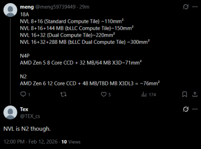

wishful thinking -> 48 + 3*48 = 192mb per CCD
Wouldn't that be less technical feasible? I mean atm they are using 1L 64MB die. I guess stacking 2 of those, if they wanted to stack would have been easier than producing smaller 48MB dies and stacking those 3 times. If for some reason, they would need L3 areas to match, so 48MB in CCD and 48MB in X3D die, then to recoup the capacity I could envision them doing 2L, so 96MB of additional L3. That is 144MB of L3 in total, matching Intel in marketing wars, and easier to produce.

Z O X
Oct 31, 2022
40
47
61
One generation of the cache chiplet matching CCD size is not "always an exact match". Zen6 could move the cache back on top, or use structural silicon underneath.
Why not on both sides for cache galore?
It is always an exact match since they moved to wafer on wafer stacking.
So it's 48MB L3 in one plane and only 2*64MB underneath the whole CCD area (L3+12 cores)?
Doesn't seem logical or am I missing something...
