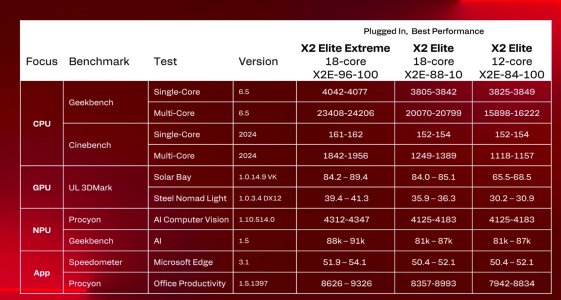

QC got 19% off a single shrink with a tiny bit of Vmax cranking.
Qualcomm cores cranking up doesn’t seem impressive to me.
Their standard X2 Elite N3P core clocks up to 4.7GHz. The M5 does 4.6GHz but it’s wider and more fat AND more efficient/faster than QCs.
yes it’s small but that’s the only thing going for qc. So to do well in benchmarks they needed to use N3X.
It's still a huge core going 5G at 2.2mm^2 on N3x. Good.
I'm not sure M5 is actually more efficient than non-5G Pegasus parts.
It's good.
It's speedy and fast and stuff and going fast is nice.

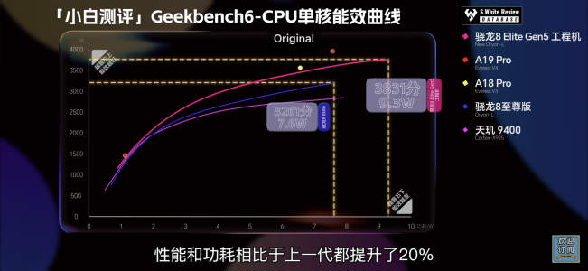

Not nT. LITTLEs carry Apple there.
I mean general 1t efficiency in GB6/sir2017 1 copy etc etc.
i mean ST.
4.6GHz V3 is slower vs a 4.2GHz A19 P core. This is the best picture I can give you. But we will know more whenever QC launches X2 elite next year.
