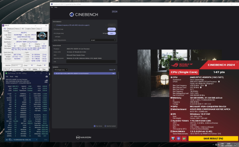

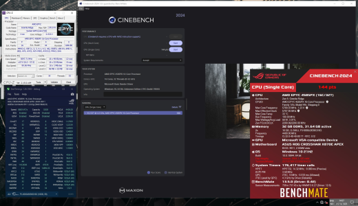

I just tested on my system, first ran on v-cache CCD then on regular CCD @ 5.7ghz static
X3D Zen5 core @ 5.7ghz = 147 points in R24 ST
Vanilla Zen5 core @ 5.7ghz = 144 points in R24 ST
Thats not stock though. Stock chips dont hit 5.7 on the X3D die and dont even always pin max boost on vanilla die on heavy 1t loads. And you have wildly OC'ed memory, lol. The 139 is what you generally can expect with normal setup and EXPO 6000 CL30'ish memory. But I digress, its still just a 3.6% difference.

Yes i agree, my memory setup is heavily overclocked.
But i also expect Zen6 with its silicon briges to mop the floor with my SerDES connection, even if i'm running at 8800/2200
(Cinebench R24 actually scales with memory performance, atleast in MT)
So for a hypertical Zen6 X3D core @ 6.5ghz with +10% higher IPC, you would be able to reach ~184points in R24 ST
"Thats only 22% faster" than my maxed out X3D core. (~152 points)
Allthought i think it's more realistic to expect something like ~175 points for the "average user"
