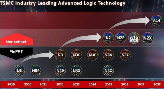

Geez, sometimes the roadmap is so stupid and yet people still believe Zen6 12-core CCD will be fabbed by N2P/N2X....
Let me repeat: Venice is 32-core CCD fabbed by N2; not N2P or N2X. Meanwhile 12-core Zen6 will be fabbed by N3P/N3X. I am more inclined to believe it's N3X, same as Zen5 CCD, N4X. The rest of Zen 6 APUs and Soundwave will be fabbed by N3P. And it is aligned with TSMC's roadmap. That' why it is funny MLID speculated Zen6 will be delayed based on AMD roadmap; even though TSMC roadmap shown something more believable. :rolleyes:

N2P is a big jump from N4P. If they reach clock targets with N2P, why bother with N2X for +5% clock rate and risk delays? Especially when the sole reason should be CCDs to reach high desktop clock rates (smallest of all markets). Server does not need it. Mobile does not need it. Consoles don't need it.
And I assume the "N2P" variant AMD is using is still somewhat customized for Zen 6.

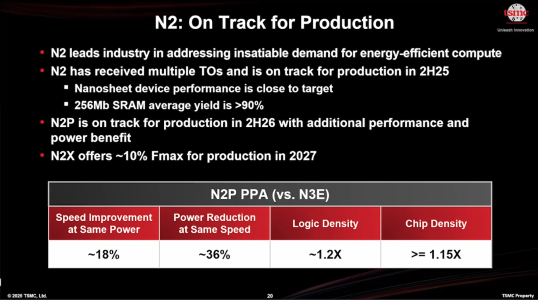

ETI4711
Oct 25, 2025
14
27
51
From the TSMC Symposium 2025:
https://www.tsmc.com/english/node/223# Technology Leadership Dr. Yuh-Jier Mii
N2X is for production in 2027, too late for Zen 6.
N2P is on track for production in 2nd half of 2026. This is start HVM, not first products with N2P delivered.
The numbers are N2P vs N3E. Why do you think TSMC is comparing not to N2?
basix
Oct 4, 2024
291
594
I assume N2X gets compared to N2 vanilla on that slide. And as N2P already brings a Fmax boost, N2X won't bring too huge gains.
But anyways, the point is that the jump from N4P to N2P is much bigger than N2P to N2X. Maybe 80% of the overall Fmax gains TSMC states. So N2X might be good for Zen 6 desktop but it will not win the game.

reaperrr3
May 31, 2024
166
487
yeah cuz it taped out a while ago on N2p.
Can we even consider N2P/X separate processes at all?
As far as I understood, one of the newer N3 chips (forgot if it was Snapdragon X2 or some Nvidia chip) uses N3P with some N3X transistors for clock-critical parts, so I'd assume this kind of mix is possible with N2P/X too and AMD would only design one 12C CCD, and not one N2P variant and one N2X variant.
