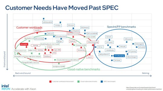

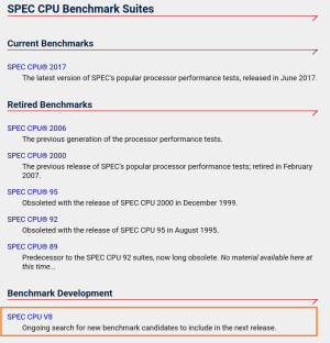

Is SPEC irrelevant now? Does AMD agree?
Well SPEC 2017 has a lot of outdated tests, some tests ranging back to two decades even which kinda needs to be updated for modern day relevance.
There should be a new SPEC version coming in some time. AFAIK AMD, Intel and others already to some level of internal tests on that(SPEC CPU V8).
All that being said SPEC CPU 2017 and many parts of it are still somewhat or lot better than what recent Geekbench versions are doing(SME boosting ST that largely? is it even that relevant so soon in everyday applications) for providing overall score.
SPEC CPU cadence:
SPEC CPU V8 has some very interesting new things coming.
OTOH SPEC has one issue that Geekbench doesn't have: compiler cheating; the only vendor compiler used for GB compilation is Apple clang, but as far as I know they don't play games with it. In both cases, one should not look only at overall score.

Given the efforts they spent to "tune" AOCC for SPEC, I'd say they disagree :) And given ICX "tuning", Intel also disagrees.
Do they give higher uplift in SPEC specifically compared to other codebases? I remember Phoronix was doing AOCC against vanilla clang, but since Phoronix is not doing SPEC I was not able to find a place that would compare the two (aocc vs vanilla clang) on the same hw/os in SPEC.
Doug S
Feb 8, 2020
3,794
6,725
They are different tests. SPEC is a system test, and sees the compiler as part of the system. That was universally true when SPEC originated in 1989, every workstation vendor shipped their own compiler. You could use gcc, but its performance back then was abysmal compared to the vendor compilers. Since SPEC has diminished in importance for driving sales versus the 90s and early 00s it is probably no longer worth it for vendors to invest in making their compiler cheat at SPEC.
Even without cheating SPEC gives vendors a lot of leeway to choose the best compiler and flags to produce the best result with that provided source code. You can improve results for your CPU by making a better CPU, or by making a better compiler. Geekbench aims to take the compiler out of the mix by having the compilation done in a black box and you run the resulting binary. For any given version of Geekbench (e.g. 6.5) you can only improve results for your CPU by making a better CPU.
Yes support for stuff like SME and AVX512 tilts the playing field depending on whether John can be bothered to insert assembly code to take full advantage of those features, and everyone is sort of at his mercy for whether and how well that is done. If for example he wrote AVX512 assembly assuming CPUs can issue a maximum of two AVX512 instructions per cycle and you have a new CPU that issues four per cycle it will not see benefit of that in its Geekbench results for the existing releases of Geekbench, and won't see it in the future unless/until he rewrites that code. Of course in SPEC you probably won't see it at all, since compilers generate AVX512 instructions only in limited cases.
