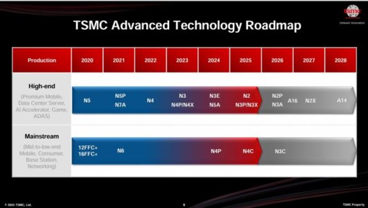

Still TSMC A-next will probably be a clean sheet forksheet node and not N3+++ like A16.
And that didn't last long, A14 is just a new GAA node.
Boring, no SPR in the first version either so they are playing it very safe.
Don't see much reason to use it early over matured A16 unless the wafer cost is good.
