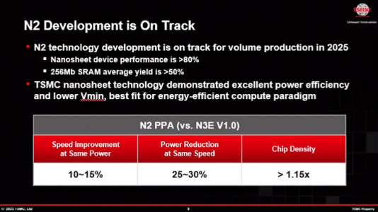

my guess N2X gonna be ~20% more speed at same power
adjustable on runtime between perf/power or its fab design choices?
combine IPC increase with big node jump and bigger CCDs and you have Zen 60%
Stop with the delusional takes, it gets tiresome. Zen6 might very well be the better product (I hope so) but there is absolutely no evidence suggesting N2X will have 20% better performance (not density) than 18A.
It might be in the ballpark but suggesting it's flat out better by 20% is ignorant fanboyism. Will we se you publicly eat crow, when this instead turns out to be accurate?
More likely you'll just shift some goalposts

I think that was in comparison to N3E not 18A perhaps?
Reactions: fastandfurious6
Jun 1, 2024
983
1,095
delusional?? me? but I'm the prophet!
yes the comparison is to N3E (as the graph shows) and numbers will be much higher over Zen 5 (N4P)
that being said, my prediction is Intel A18 ~= TSMC N3, so it might also be comparison to A18 lol!

I think AMD will Keep It Simple with Zen 6. 24 cores and ~10% IPC increase, maybe a few hundred MHz frequency increase under load due to lower power with the new node. Put it all together and you've got a solid bump from Zen 5.
As optimistic as I would like to be on this one, I think you are likely correct. This is doubly true if I am right about AMD sticking to N3P for desktop Zen 6.
I don't think N2X is, uh, "lower power".
Anything N2 is going to be significantly lower power than the current N4P Zen 5. Not sure where you are coming from here.

I don't think it is about absolute performance anymore. If AMD wants absolute performance, it will be filled by Threadripper, not with their standard desktop offerings (or laptop offerings). From a strategic point of view, AMD is beating the crap out of Intel by making competitive products that are much less expensive for them to make.
In engineering, it isn't all that difficult to create a superior product if the price of that product is not a consideration. We did put a man on the moon in the 60's after all.
I think Intel's Total Cost of Ownership for 18A is going to be beyond prohibitive. I believe it will be very performant, but not cost effective. Intel is bleeding money badly. They need to start thinking much more like AMD and think about the COST of architectural decisions, not JUST the performance.
Think about the REAL reasons AMD is ahead.
  1. Higher yields and lower cost per die through chiplets (and the architectural enhancements in the core and interfacing that keeps the performance high despite the higher connection latencies).
  2. HPC dominance through the Threadripper product offering
  3. DC dominance through Turin and Turin D by use of a very effective IOD and multi-channel memory feeds.
It isn't at all just the transistor technology anymore. Intel desperately needs to understand this IMO.
No it wouldn't lol, it's all speed gainz all the way thru.
Everyone and their mom are juicing their designs.
Speed is king.
