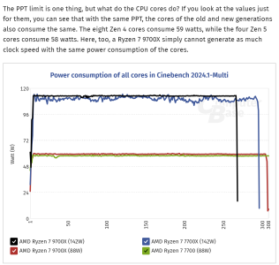

Problem is that Computerbase has this for CB 2024, someone said that it could be the cores power wthout the uncore but from the 7950X review it s clear that they measure the whole package power.
PPT limit of the 7950X is 230W and under sustained heavy MT workloads, it tends to sit around 215-225W due to hitting thermal limits (vs. Sitting closer to or hitting 230W PPT limit). The graph appears to show ~200W, which seems like it would be in the neighborhood of core only power.
That someone was me. And yes, they usually measure package power, but for that specific measurement they only measured the cores. It's described in the text. How about just using auto-translate:
No, there s peaks over 200W, beside the CPU use only 189W in Handbrake wich is the app used for this test and 196W in Prime 95, from their measurement at the main power in Cinebench can be estimated accurately at 215W peak at most.
And yes, I still need to point out the "four cores" mistake to them. That's 8 cores for all the lines.
So the uncore use 30W like in the chinese review, wich is a lot for Cinebench, and as i already pointed that s the cause of the perf being mediocre relatively to the 7700 at low powers but eventually also at higher powers albeit to a lesser extent.
Wow that's mid. Again, I can not wait for that spec2017 int power curve lol.

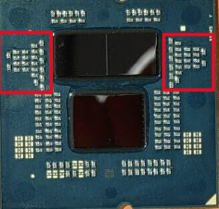

The reason why 8000MT is doing little to nothing is the number of GMI links. Single link is the bottleneck for throughput. So going with higher kits will make sense only for dual chiplet SKUs. And 1:1 mode is less important for x3D SKUs because they have the 3d cache to insulate from DRAM latency.

Just keep in mind, that you need both CCDs active to see the improvement in Mem BW. Because each CCD has only one active GMI link to IOD. But the CCD itself has two GMI interfaces [at least this was the case with Zen4 and this was a reason why some lower core count SKUs had 2 links enabled, to ensure they could better tap into socket's bandwidth].
Likewise for Strix Halo, what will be important is how many GMI links will be active as this will decide how much of the overall bandwidth CPU can use. I think Adroc claimed that 2 links will be active, but until they release the product we won't know for sure.

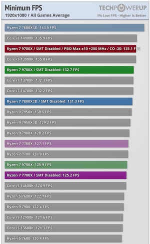

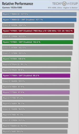

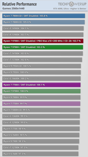

Seems like either windows 11 or nvidia drivers needs to update the thread scheduling for Zen5 (?)
That's at least my take on this data..
During the course of our testing, we observed that Windows 11 was scheduling workloads on the 9700X in a manner that would try to saturate a single core first, by placing workloads on each of its logical threads. Additionally, the placement would put load on the CPPC2 "best" or "second-best" core (gold and silver in Ryzen Master)—which makes sense. However, if a highly demanding single threaded workload runs on one core, scheduling another demanding workload on the second thread of that core will result in lower overall performance. It would be better to place them on two separate cores, where they each have access to the full resources of that core. We hence set out to see if this is an SMT-specific problem.
Don't think i've observed this behavior on my 16 core Zen5
That graph shows improvement of only 1.5% with SMT disabled... Which isn't exactly massive.
Depending on the set of games, sometimes SMT improves the result, sometimes it makes it worse. I doubt this will lead to a rewrite of Windows scheduler.
