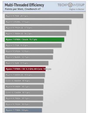

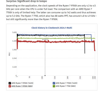

Zen 5 also doesn’t seem much more efficient than Zen 4 like everyone is saying when we compare the 9700x and the 7700.
View attachment 104954View attachment 104953
Of course since efficiency is traded for more performance than the 7700, but if you set the 9700X at same perf than the 7700 it would consume about 60W vs 80W for the 7700, so 30% better efficency at isoperf, that s remarkable given that the core is much bigger and the node jump relatively modest.

Of course since efficiency is traded for more performance than the 7700, but if you set the 9700X at same perf than the 7700 it would consume about 60W vs 80W for the 7700, so 30% better efficency at isoperf, that s remakable given that the core is much bigger and the node jump relatively modest.
Not really. It has a 5% advantage in pts/w over the 7700 on CB nT.IMG_7787.jpeg

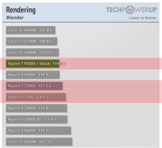

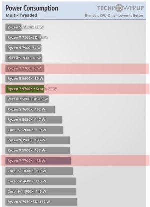

The TPU review has the 7700 using slightly less power pretty much across the board. Both are using more than 60W in CB 2024 nT.

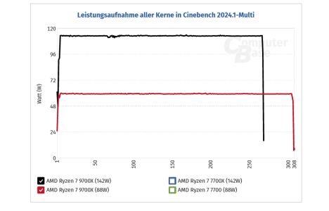

I completely doubt that graph.
We ll have to wait for confirmations, what is odd is that Computerbase had the 9700X idle power at 27W, wich is excessive, and if the CPU use only 60W then it means that the cores are fed with only 33W.
On the other hand the 7700 use about the same power but they measured its idle power at 13-14W, wich would amount to 46W for the cores and hence 40% more cores power than the 9700X.
What is even more weird is that Hardwareluxx measured 14W idle power but got the same CB 2024 score, wich after all is possible since there s enough power headroom left for the Computerbase sample, but that would mean that Hardwareluxx sample did use only 47W overall in CB 2024, wich is dubbious, so possibly that we ll have revised reviews next week when they test the bigger boys.

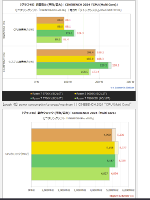

No, the 60W number is for the cores, without SOC. Add the 27W and some change for the correct 88W PPT in total.
And yes, the 27W indeed seems excessive, considering they used RAM at JEDEC timings, so the memory controller should not be in OC mode.
poke01
Mar 8, 2022
4,883
6,224
No, the 60W number is for the cores, without SOC. Add the 27W for 87W in total.
yep. Look at PC Watch, it adds up. No need to wait.
They measure power at the 12V CPU power rail, so that include the VRMs losses wich are about 10-12%, so their CB run is at 65W or so, that s comparable to Computerbase s 60W.
That s the full Soc power since they get about 90W peaks in Blender, previously they always used the CPU package power, wich include the uncore.
Indeed their methodology is curious, they measure the power with Blender at mid test, peak value and minimal value, there s something flawed here because they get the 7700 minimal power at 24W while in all their previous reviews it was about half this value.
