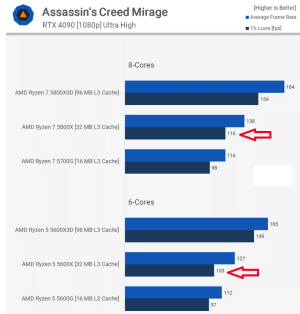

It may help because most games won't go above 16 threads which will ensure no thread needs to go outside the 8 core CCD. On 6 core CCD, the number of threads prove insufficient and some game/gpu driver threads need to be moved to the other CCD.
Like look here: https://www.techspot.com/review/2811-cpu-cache-vs-cores/
That depends on nature of communication, what you advocate would help if the threads are talking to each other heavily, but if they are just workers spawned to do something and die then CCD2CCD overhead doesn't matter that much and 6C x 6C could be better due to more balanced nature [same amount of LLC per core, where 8x4 would require more complex scheduling logic to extract max performance]. After all there are some gaming benchmarks were 7900x is leading 7700x.
And who assigns CPU affinities to the game threads to ensure that they don't wander off to another cache domain?
This test was done without locking the core clocks.
Edit,
Incidentally, the Linux kernel's process scheduler ignores last level cache domains in its scheduling decisions for threads of the same process. This is in contrast to NUMA nodes, for which the kernel implements the default policy to try and keep all threads of a process on the same node. I don't know why such a policy is not applied WRT cache domains, but I suspect it is because the optimum for performance cannot be predicted by the kernel. I don't know what Windows' process scheduler does in this regard.
Not sure what you're saying here. Yes some games require more threads than 6, but how does that help when windows will put threads on both CCDs. You still get cross talk in 8+4, plus that doesn't address the point around binning. It doesn't make commercial sense, which is backed up by the fact we haven't seen this config.
I would assume game developer as they best know the nature of their own workload. Look up Cyberpunk settings for CPU, they have very basic option for this exposed to the user. Generally there are windows api that let you outright pin workloads to specific cores [though they are generally not recommended as you might shoot yourself in the foot] or to suggest to the kernel it should keep specific threads together on specific sets of cores. It's even mentioned in publicly available resources from AMD, but I don't have them at hand and can't look them up right now.
