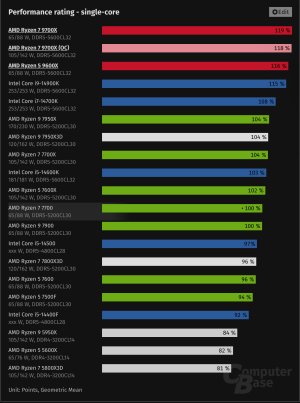

Why do you always jump to anti-AMD conspiracy theories? I doubt he’s maliciously “tricking” the numbers to make AMD look bad.
SoC power is directly tied to memory kit and motherboard defaults. One could be using an Asus, the other Asrock both have different default vSoC target voltages. There’s a bunch of other explanations than a conspiracy.
I didnt say that it was voluntary but lack of care in the tests will amount to the same conclusions, indeed there s also weird things at Hardwareluxx as well, i would think they would have spoted the discrepancies, for the time let s say that
these are non finalized bios and set ups, we ll see in the 9900X/9950X reviews.

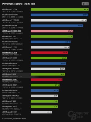

As to anti AMD theory just look at Computerbase previous MT tests since this one has been updtated for Zen 5 release, although they corrected the weird ST tests they still moved their MT scores in favour of Intel.
Now the 253W limited 14900K match the 7950X while in their previous MT scores the 320W unlimited one was 1% behind and at 253W it was 4-5% behind, of course it couldnt be the other way around, isnt it, but guess that most people didnt even notice the shift.

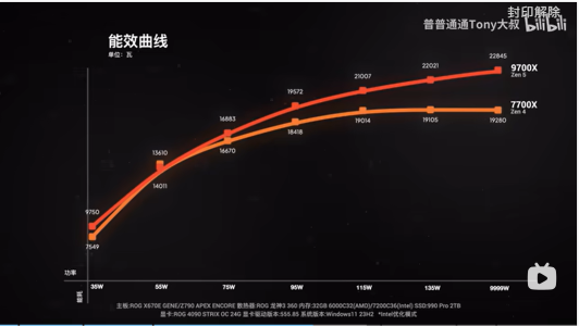

Zen 5 also doesn’t seem much more efficient than Zen 4 like everyone is saying when we compare the 9700x and the 7700.
View attachment 104954View attachment 104953
Of course since efficiency is traded for more performance than the 7700, but if you set the 9700X at same perf than the 7700 it would consume about 60W vs 80W for the 7700, so 30% better efficency at isoperf, that s remarkable given that the core is much bigger and the node jump relatively modest.

Of course since efficiency is traded for more performance than the 7700, but if you set the 9700X at same perf than the 7700 it would consume about 60W vs 80W for the 7700, so 30% better efficency at isoperf, that s remakable given that the core is much bigger and the node jump relatively modest.
Not really. It has a 5% advantage in pts/w over the 7700 on CB nT.IMG_7787.jpeg

The TPU review has the 7700 using slightly less power pretty much across the board. Both are using more than 60W in CB 2024 nT.
