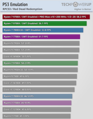

That graph shows improvement of only 1.5% with SMT disabled... Which isn't exactly massive.
Depending on the set of games, sometimes SMT improves the result, sometimes it makes it worse. I doubt this will lead to a rewrite of Windows scheduler.

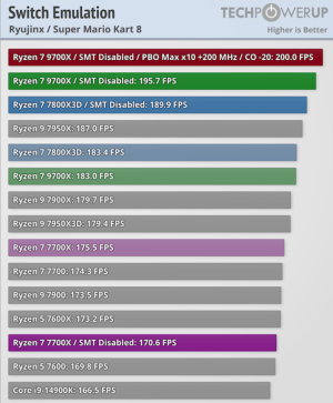

Updated screenshots
Its 1.5% at 4k res, higher at lower res
Some more screens

Updated screenshots
And at lower res, you can see the same kind of thing for Zen 4 as well. This has been the reality of HT/SMT since it was first introduced decades ago. Sometimes it helps, sometimes it harms, but the overall consesnus is just turn it on and forget it.
A completely reworked core, is going to shift SMT behavior somewhat, but there isn't anything that significant going on here, except a whole lot of cope grasping at straws.

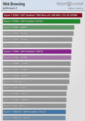

Two areas in which Zen 5 notably improves over Zen 4 have been pointed out here:
  • vector arithmetic,
  • web browsers/ JITs and the likes.
Glancing over the TPU review, it appears there is another area:
  • databases.
MySQL TPC-C test:
9700X ......... 15,200 TPS (126 %)
7700X ......... 12,900 TPS (107 %)
7700 ........... 12,100 TPS (100 %)
7800X3D .... 11,700 TPS (97 %)​
MongoDB 6, time for 10M requests:
9700X ......... 67.5 s (141 %)
7700X ......... 90.0 s (106 %)
7700 ........... 95.4 s (100 %)
7800X3D .... 98.3 s (97 %)​
edit: added relative performance, Ryzen 7700 as baseline

Seems like either windows 11 or nvidia drivers needs to update the thread scheduling for Zen5 (?)
Don't think i've observed this behavior on my 16 core Zen5
Issues like this *might* be caused by a power-saver or bugged power plan/scheduling scheme. "Filling" all physical cores first should be the energy efficient strategy.

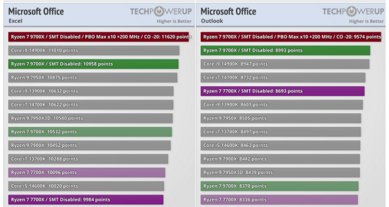

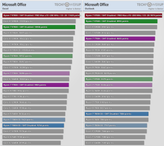

28,174
19,219
Some more screens
I love how the situation totally changes with SMT off in Excel and Outlook, arguably two of the most used applications in offices all around the world:
7700X with SMT disabled is closer to 9700X SMT disabled in Outlook but loses any chance whatsoever in Excel, which really fills me with delight!
Now just gotta wait for Excel 2024 with AVX-512! :D

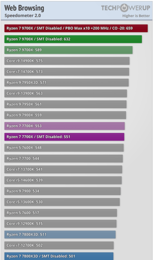

That's a...non-insignificant gain in front-end bound workloads like browsing. I expected less.
2 decode clusters doing work?
I don't know if the two decode clusters can actually serve a single thread in practice. However, the µop cache does seem to work, in that the machine can do two taken branches per clock from µop cache, which is very useful on it's own when running interpreters.
Gotta wait for C&C article to finally get some clarity on this.
