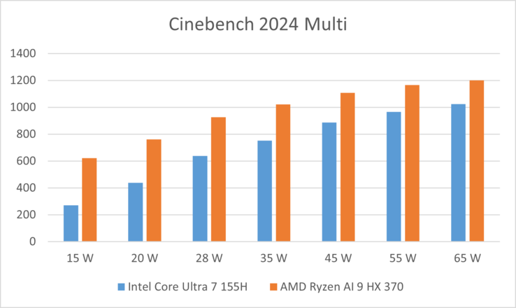

Power/perf scaling according to NBC.

desrever
Nov 6, 2021
328
806
So this means H370x is more than double the performance of the 155H at 15W, probably almost double the 185H too. Good luck to to Lunar Lake to catch up with advertised 50% improvement.
Really funny people here are acting like these aren't the best mobile CPUs outside of Apple.
