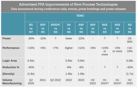

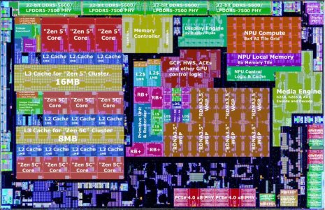

Ian said that Zen 5c would see a much smaller drop in frequencies compared to what Z4c had relative to the classic cores.
Interesting.
[...] AMD said this during the post-tech-day briefing in the context of Strix Point's N4P Zen 5 cores and N4P Zen 5c core sizes, the latter being just 25% smaller than the former. (Whereas the difference was 35% between Phoenix 2's Zen 4 and Zen 4c cores.) These lowered space savings are because AMD had to work within stricter constraints WRT Voltages and clocks in order to make the compact cores work as a support to the classic cores the way as AMD wanted them. [...]
If I am looking at this right, they did manage to compact the core logic by quite some degree but, as to be expected, L2$ and L3$ diminish the overall area savings a lot. (The 8 MB L3$ of the Zen 5c CCX looks even less dense than the 16 MB L3$ of the Zen 5 CCX, but this is surely because of twice the number of cores to connect at the former.) The f_max which Strix Point's compact cores are designed for is probably OK for the limited TDPs for which this one is targeted at, and higher TDPs will really need to be covered by Fire Range...
Reactions: lightmanek
Geddagod
Dec 28, 2021
1,296
1,368
No. AMD said this during the post-tech-day briefing in the context of Strix Point's N4P Zen 5 cores and N4P Zen 5c core sizes, the latter being just 25% smaller than the former. (Whereas the difference was 35% between Phoenix 2's Zen 4 and Zen 4c cores.) These lowered space savings are because AMD had to work within stricter constraints WRT Voltages and clocks in order to make the compact cores work as a support to the classic cores the way as AMD wanted them.
(Source: Computerbase's article on this briefing. Also take Tom's Hardware's interview with Mike Clark in which the Zen 5c design targets are discussed in the context of heterogeneous CPUs, read: Strix Point. PS, I haven't watched the Cutress X Cozma video.)
Didn't see that, nice catch. Sounds like AMD wanted the dense cores to be more effecient at higher frequenies due to the fact that they are in their mainstream mobile lineup now.
