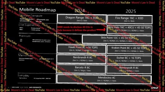

Figures I've saw being throwed some time ago was around 170 - 180mm²
It comply with the Microsoft marketing point, it will be featured into newer designs and with more design wins, it will have a branding that indicates it's a new generation part
certainly.
and will also slot into a cheaper price bracket than HWK.
That I am not sure about. Phoenix/Hawk Point laptops have gotten much cheaper since they launched. And if Kraken is indeed 170-180 mm², then it's pretty much the same die area as PHX/HWK (178 mm²).
Edit: This leaked slide may give some insight:
